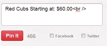

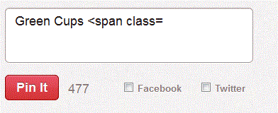

I am starting to wonder if the HTML codes you use to style your description is messing it up. Because it is trying to render them in the pinit description. Hmmm...
Re: creinold Pinterest Button Addon
creinold
Can you change one of your products descriptions to be just basic text description no html style and test it. Ie: No font tags, no order list / unorder list... etc/// Just text and that's it....

http://frompropertorocker.com/every-...ce-p-3981.html This is where I changed the text.
Okay the addThis server don't like the zen-cart product url code for some reason. I got to research why. Should just echo the url for the product. I wonder if is an SEO add on that causes the problem. What SEO add on you are using?
it's echo your URL to your product page as: http://frompropertorocker.com/product_info
instead of: http://frompropertorocker.com/every-...ce-p-3981.html
The media tag is working good. Not sure why it doesn't show up in the popup when I press the pintrest button. the url to the image is: http://frompropertorocker.com/images...-piece_MED.jpg which shows it loaded correctly but image not showing up in my pop-up? Weird? Must be something with addThis... Another research item.
I figured out a the description tag.
<?php echo stripslashes(strip_tags($products_description)); ?>
You can try that on the addThis thingy also.
That will strip the HTML char from the description. I will add that to my next pinterest update.

I just noticed that there is Pin It text under my photo and if you click that the description comes up. Not sure where that came from.
nolsowski
Okay now I noticed when I went the description page and added my font size and font choice now I get the duplicate description back up.

The image works now but my pin it button is gone and so is the description.
opps I forgot to strip the html from the description... here the correct code:
<!--Bof creinold Pinterest Modifications, (You can move this anywhere you like the Pin it Button to show up on Product Info page.) -->
<div id="pinterest"><a href="http://pinterest.com/pin/create/button/?url=<?php echo zen_href_link(FILENAME_PRODUCT_INFO); ?>&media=<?php echo HTTP_SERVER . DIR_WS_CATALOG . $products_image_medium; ?>&description=<?php echo stripslashes(strip_tags($products_description)); ?>" class="pin-it-button" count-layout="horizontal">Pin It</a></div>
<!--eof creinold Pinterest Modifications, (You can move this anywhere you like the Pin it Button to show up on Product Info page.) -->

Now the image doesn't work. lol
Okay try this now:
<div id="pinterest"><a href="http://pinterest.com/pin/create/button/?url=<?php echo zen_href_link(FILENAME_PRODUCT_INFO); ?>&media=<?php echo $pt_image; ?>&description=<?php echo stripslashes(strip_tags($products_description)); ?>" class="pin-it-button" count-layout="horizontal">Pin It</a></div>

Where I have Products Price (Net): and Products MSRP: added, I am getting the "<span class=" at the end of Product name?
Attachment 12247
Also where the price is set by attributes, I am getting <br>
Attachment 12248
Any ideas?

does anyone know where "zen_get_products_display_price" is defined ?
When I take it out of the code <span class= and <br /> go away!
But the price disappears also.
