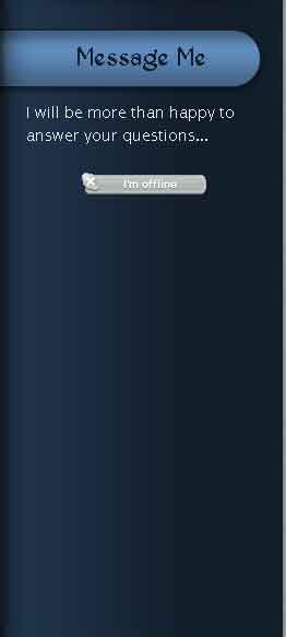

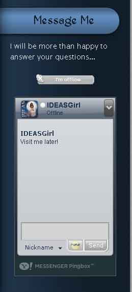

Hi BillyBoyle,
Sorry for the delay but has been busy...
I tried this tonight and it breaks my cart (I believe the only change was on the module file?). Here's my copy as my sidebox parameters:
* blank sidebox - allows a blank sidebox to be added to your site
* @package templateSystem
* @copyright 2007 Kuroi Web Design
* @copyright Portions Copyright 2003-2007 Zen Cart Development Team
* @version $Id: blank_sidebox.php 2007-05-26 kuroi $
// test if box should display
$show_messageme_sidebox = true;
if ($_SERVER['HTTPS']== 'on' ){
$show_messageme_sidebox = false;
if ($show_messageme_sidebox == true) {
require($template->get_template_dir('tpl_messageme.php',DIR_WS_TEMPLATE, $current_page_base,'sideboxes'). '/tpl_messageme.php');
$title = BOX_HEADING_MESSAGEME_SIDEBOX;
$title_link = false;
require($template->get_template_dir($column_box_default, DIR_WS_TEMPLATE, $current_page_base,'common') . '/' . $column_box_default);
Here's what happens: http://img39.imageshack.us/img39/1736/aquatic.jpg
Let me know if I have to make changes in any other of the files or if there's something wrong on this one.

Oooo that's not good.
But just like the blank you are using you need to work between 3 files. The contents I show is in the defines file. Tell you what, send me your 3 files for blank sidebox and the message me files, if you don't mind. I'll build the mod and send it back to you.

You do seem to have it kind of half implemented, as when I change the protocol to https some of the contents of the box don't show.
Your Sidebox goes from this
Attachment 10716
To this
Attachment 10715
So there is something going on with it, but without access to your pagecode I just don't know sorry.
You did back-up didn't you? load the page from before the mod, apply the same changing to secure sidebox as you did to blank sidebox (they are just the same basic sidebox template) and see how that goes.
Wish I could be of more help at this time. Billy
