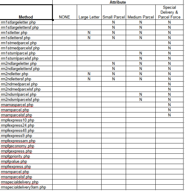

How do I handle having items of the same weight that need small or medium packaging based on quantity or item size?
I want to do this without giving customers both options to pick from since they will always pick the cheaper option.
I too am eagerly awaiting a resolve to this one.... It's a nightmare!
As medium is based on size and there is currently no way of determining size and the complexity or trying to put items together to fit into a size I would suggest that you turn off small parcel. The only other alternative would be to add a flag into the database and then modify the mail code. I have not looked at this. to do it properly is a major rewrite and requires additional attributes fro the products.
Yes postage by size is an issue and a major pain. :(

I have now completely rewritten Big royal mail version 3.2.0
I have included the insurance as standard in each application and added the parcel force postage methods to the pack.
I have also included a method of using attributes to exclude certain shipping methods. Table below show methods excluded for each attribute
Attachment 13392
