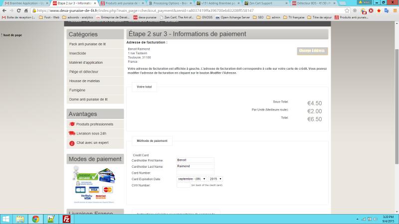

<input type="image" src="includes/templates/template_default/buttons/english/button_continue_checkout.gif" alt="Continue" title=" Continue " onclick="submitFunction(0.00,102)">
My cart has $102.00 in it so I assume that is what is being passed in the submit. However, it does not advance me to the next step. I'm completely out of ideas. Are the database scripts that need to be run that aren't in the instructions? It almost seemed too easy to install, and something definitely seems to be missing.

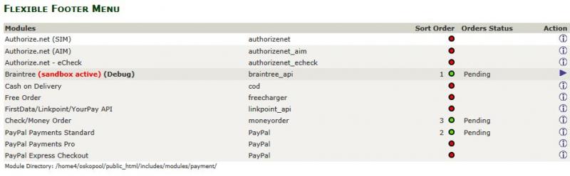

But yet Braintree is receiving all the orders, the customer gets their email, I can see their orders on the main orders page in my Zencart admin:
Attachment 13576
I can also click on "Invoice" or "Packing Slip" and see all of the information. But when I click on the GREEN CIRCLED "e" or click "Edit", I get this:
Attachment 13578
Totally confused now. PayPal and Money Order options seem to work without any errors.

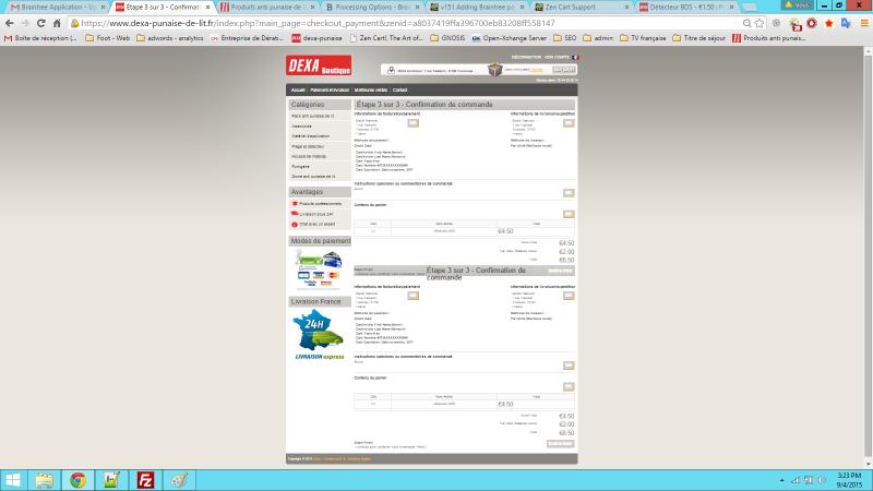

Anyway, I am also wondering if the problem is within the step 3 of 3 in the checkout process.
Attachment 13586
(Since, my EDIT the customer order page only shows information down to and including the Card Expiration Date and nothing else below that).

Hi guys,
I read all the threads of this post but I could not find the answer to the bug I am experiencing.
My website is:
https://www.dexa-punaise-de-lit.fr
It has the SSL. The Admin/configure.php file is good.
In the database, I see only the braintree file (no table_, no zen_)
My host is ipage (ftp.ipage.com)
The website is in French. I do not use the english folder but the french folder (not sure if this is important or not).
The account has been approved by Braintree. It is in EUR.
I generated new API keys and use them in admin/modules/paiement => braintree
I found the merchant account ID at the bottom of Processing Option.
I try to buy this product in the website:
https://www.dexa-punaise-de-lit.fr/i...products_id=55
During the checkout process, I login, click on "continue".
The braintree module does display the credit card box where I am being asked my credit card details. (see braintree-zencart1.png below)
I fill the info then I click on "continue".
And the first bug appears (see braintree-zencart2.png below). Basically the order confirmation ("confirmation de commande") is displayed twice on the page.
Then I click on "confirm order".
And the second bug appears (see braintree-zencart3.png below). It goes back to step 2/3 and displays the following error message: "Message: Amount must be greater than zero."
Could someone please help me?
P.S. The module has been installed by numinix. I did not change anything after they installed it.
Attachment 15578
Attachment 15579
Attachment 15580
Benoit

Hello Everyone,
Although this module was working with my Zen Cart 1.5.0, it is not working with Zen Cart 1.5.4 installation.
I am using Zen Cart ver. 1.5.4 and Braintree 1.3.1 and the Winchester Black theme...., Since my database does not have any Prefix's, I have changed both files under includes/extra_datafiles/braintree_api.php AND admin/includes/extra_datafiles/braintree_api.php to:
PROBLEM 1: After filing out ALL of the Credit Card info on the Step 2 of 4 - Payments page, and I click on CONTINUE..., the page does not change or go to the Step 3 of 4.... page..., it just stays the same. However, the pages "tab" changes to Step 3 of 4.....Code:<?php
define('TABLE_BRAINTREE', 'braintree');
PROBLEM 2: If I miss filling out a field in the Credit Card info on the Step 2 of 4 - Payments page, and I click on CONTINUE..., the "pop-up" does tell me that I have to correct something..., and the error is highlighted in red near the incorrect input field..., and the highlighted in red message tells me what is wrong. But no matter how many times I correct the input field..., the highlighted red message remains and is duplicated and added onto the first message. (Below I have pressed CONTINUE 3 times without a card number)
Attachment 15878
Also, in my Zen Cart admin panel under "Modules/Payment or/Shipping or/Order Total" the page title says "Flexible Footer Menu"??? I don't think that this is causing any problems, but I'm not sure??
Attachment 15879
Any thoughts or suggestions???
Danny
Danny,
You shouldn't need to remove the DB_PREFIX as that should be defined in both your configure.php files.
Please check your database and verify that the table called "braintree" exist and NOT "TABLE_BRAINTEE"
Additionally the Flexible Footer Menu title is actually an issue I have experienced with various templates, despite it being annoying it actually isn't harmful (at least from experience)
Well, the database file did say "braintree" without any prefix.
But just to be safe, I uninstalled the braintree plugin, deleted the SQL file, deleted all braintree files on the server, confirmed that braintree was no longer an option in my admin panels' payment options, reinstalled the entire braintree plugin, did NOT remove the "DB_PREFIX code" from the in my configure files, re-installed braintree from my admin panels' payment options, confirmed that a database file called braintree was created, filled out all of my "sandbox" info and id's and keys, logged into the website and tried to place an order, and the EXACT SAME THING HAPPENED.
