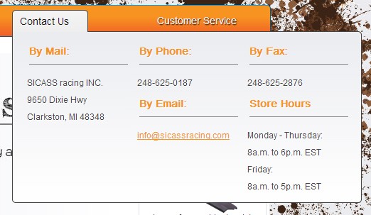

I ended up removing the code for the quick contact form from the header and replacing it with all of our contact info and a link to the contact us page...
Attachment 13444
I haven't had any error logs pop since I uploaded the changes.
Attachment 13444

Generally speaking that seems like it will help; however, it defeats one aspect of the default contact us form... not distributing/providing the email address for spiders to pickup and send spam directly... (email address is shown/provided) if it takes the user to the contact us form, great, but I thought the presence of the email address would be something that would be picked up by those searching through for such things...
