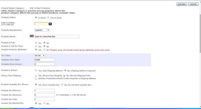

I have used radio buttons to price a product, based on its sizes.
So in the pricing screen I have kept the price as 0. This is an exempted product, hence I have created a new tax class called "no vat" & mentioned the rate as 0%.
attaching the screen shot for the same:
Attachment 14208
Next in the attribute section I have done the following setting :
Attachment 14210

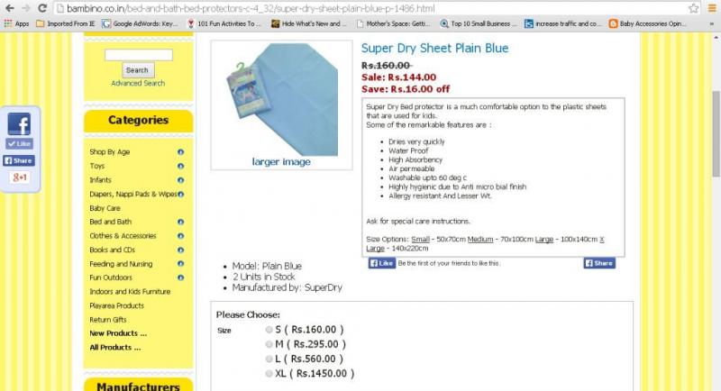

Ok. So the prices are displayed correctly now. But the main problem was that the attributed price is not taking the discounts on that category. I am attaching the screen shot of the web page for that product.
Attachment 14229
This is the updated admin setting
Attachment 14230
If you can see , next to product listing the "priced by attributes" is coming in red with correct price. But with the radio buttons, its not getting reflected on the site

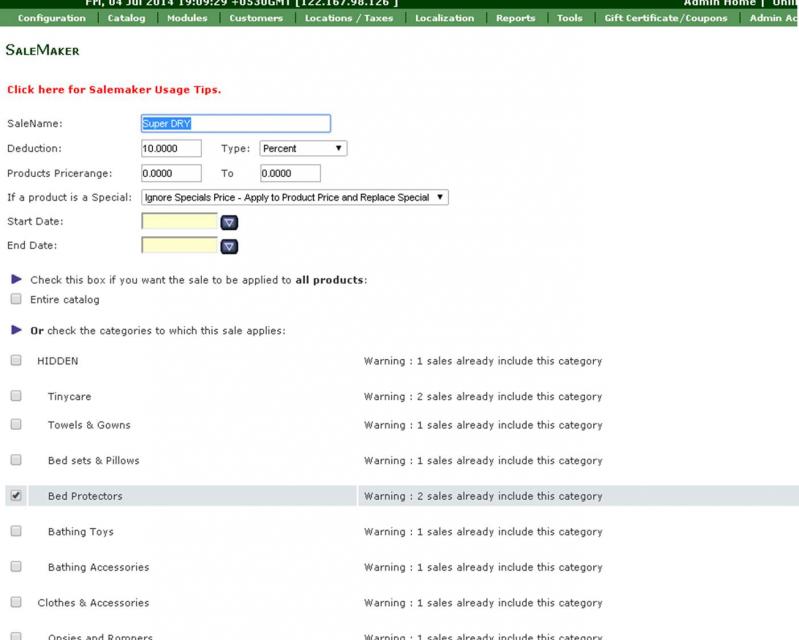

What are your settings in the Sale Maker that you are using?
---- I am using the salemaker to have a sale of 10% off on category "Bed protectors"

I am not sure but I think the salemaker is doing its job, otherwise I would not have got the display ( marked in circle) as in the image below.
Attachment 14234

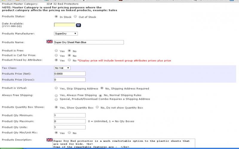

4 Attachment(s)
Re: Price not getting displayed correctly; with attributes
So here they are :
Product settings for Muslin Triangle :
Attachment 14238
Salemaker setting for Tinycare ( Master category for Muslin traingle)
Attachment 14239
Product setting for Plain blue :
Attachment 14240
Salemaker setting for Bed protector ( Master category for Plain Blue)
Attachment 14241
In SaleMaker, the checked Categories have a:
waring about 2 sales already include this category
on that line should be a (more Info) ...
Click that and see which 2 SaleMaker sales are set on Bed Protector ...
On SaleMaker settings a Category should only have 1 SaleMaker sale set on it ...

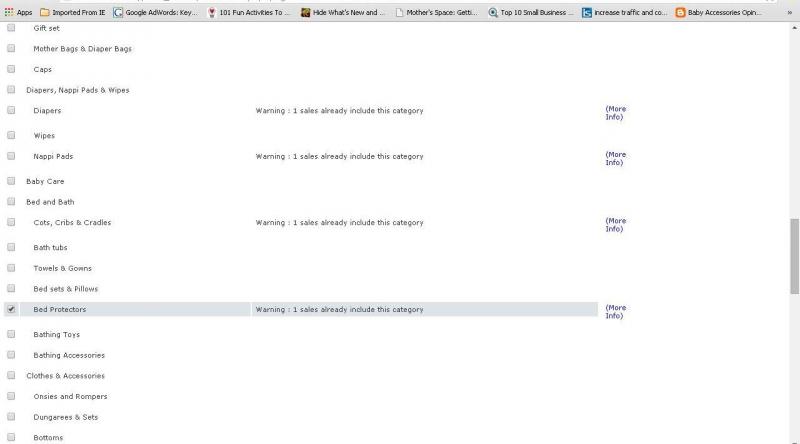

Actually more info was there.. I had cropped the picture to fit in the relevant info. Resending.
Also, I have removed one sale from there. Please have a look.
Attachment 14268

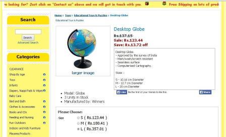

Also, yesterday, I have set up one more product , with attributes. The same issue is coming.
The only change I can see is that Tinycare products ( the ones that is showing discount properly with attributes) was done under 1.3.9h.
And the other two after upgrade.
The link to the new product : http://bambino.co.in/toys-educationa...be-p-2222.html

Any help ? If you can tell me; from your experience where I should look for ; I would be greatful !:please:
Its just that now any new product I add with attributes; I am getting the same issue.
My site - www.bambino.co.in
The latest issue is with this product - http://bambino.co.in/toys-educationa...be-p-2222.html

Let's start over on figuring this out ...
How many SaleMaker sales do you have that are active?
If you temporarily turn of the SEO/rewites, does anything change?
If you temporarily switch to the Classic Template, does anything change?
What happens if you edit the SaleMaker sale and set it to:
Apply SaleDeduction to Specials Price - Otherwise Apply to Price |
:clap::jump::bow:
You are simply "Oba-san" truly !
Its just perfect now. I never realised the meaning of these options, and kept it at the default.
Thank You again !
