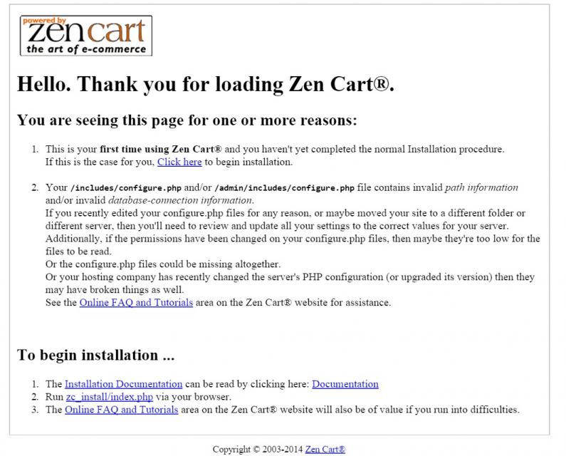

Yes, the front end and back end were all locked out. No matter where I navigated on the site, I got the screen saying congratulations, now click here to finish...
So then I did a clean install of 1.5.3 instead of over-writing 1.5.1, but that didn't make a difference. Apparently I cannot upgrade to 1.5.3. , all because of this admin password issue. To me, this is a really big problem over a very small thing.
I have an apache/linux server. I downloaded the very latest ZC version from Sourceforge.
I have a whole lot of error logs if that's helpful, but the logs seem to consistently point to the same errors that are already mentioned in this thread. I assume the any bugfixes were included in the October file?

However, now I can't get into the Admin. I get the page that says, "Hello. Thank you for loading Zen CartŪ. You are seeing this page for one or more reasons: "
I've done the zc_install setup a number of times so that's not it. I've checked the configs and the .htaccess. Just absolutely do not get the Admin login no matter what I try.
My shop has been nonfunctional all week. If I use 1.5.1, people can't checkout with PayPal even though I turned off ALL the address checking features they're still getting the 10736 error.
So I tried the upgrade again (via FTP) and now customers can't even get to checkout - because I can't get into Admin to turn things on and off.
I asked my server manager about upgrading the PHP version. We'll see if that helps.
I'm feeling rather desperate actually. ZenCart has never been this impossible before.
My server manager upgraded PHP to version 5.4
I still can't login to the admin. I think I've run the database upgrade scripts a zillion times now hoping to finish installation but it always goes to this screen in the Admin:
Attachment 14739
Here's an error that showed up in the LOGS folder one of those times. This was before we upgraded the PHP:
I'm totally locked out of the Admin and I've done everything I can think of. Suggestions?Code:[29-Nov-2014 09:29:00 UTC] PHP Warning: Invalid argument supplied for foreach() in /home/prillych/public_html/zc_install/includes/classes/installer.php on line 764
The site is working OK on the frontend, but I can't get into the admin at all. Is there any way to kill that screen?? I REALLY think the install procedure is not working right.
One thing it's doing is changing the permissions on the includes/configure.php to 444 every chance it gets, and THEN it gripes at me that it can't write to the configure.php file even though I'm constantly checking on it to make sure it's writable.
Although the configure.php files say they don't want the prefix in there, the site won't run at all unless the database prefix is in there. --- But I think that might be messing up the installation procedure, it's having a hard time writing to some of the tables. I was trying to do it manually with PHPMyAdmin, and I ended up inserting the prefix into the SQL statements, otherwise it couldn't work on the tables.
I've been using ZenCart for almost 10 years, on several sites, and I do everything myself. So it's not like I'm a newbie. I've always been able to fix things on ZenCart, but this is a real mess.
Most likely the change of the configure.php permissions is being done by the server ...
As to the Install screen, ensure that you have a good configure.php file in the directory:
/admin/configure.php
I suspect that it is either missing or the paths/database are incorrect ...

In your admin version DIR_FS_CATALOG is incorectly defined. It should be:
Some of the other defines that use that may need be shortened.Code:define('DIR_FS_CATALOG', '/home/prillych/public_html/');
DIR_FS_LOGS in your storeside is wrong (has too much information) should end with . 'logs/'); which I think is also the case on the admin side as well.
Sorry, logs should end without the slash... Misread the guidance in the configure.php file for logs...
Should be the define in both configure.php files.Code:define('DIR_FS_LOGS', DIR_FS_CATALOG . 'logs');
Oh, yes, what a relief that is. I'm in the Admin area at last. THANK YOU!
