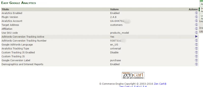

I was over in the simple google analytics thread and took your advice to upgrade to easy google analytics.
A couple of questions!
I do not have a "documentation" folder in V1.5.0. Where do I upload \documentation\css and \documentation\images?
I put \documentation\js in catalog/includes/templates/classic/js, Is this OK?
I have a critical error when I run the Tag checker, No HTTP response - see picture.
I also enclose a picture of my configuration.
Thanks for any help!

Figured out I do not need to upload the "documentation" stuff to my web site it is just part of the installation instructions.
Played around with my configuration and it works now.

I enclose a copy of my configuration for comment.
The installation is automated and I did not get any errors during installation. So where should I look for this problem?

I need help. I have zc 1.54 with Easy Google Analytics 2.4.8. But it seems to me the "AdWords Conversion Tracking" is not activated. Below there screenshot of my set Easy Google Analytics.
Attachment 16005
Can anyone let me know, I went wrong it?
