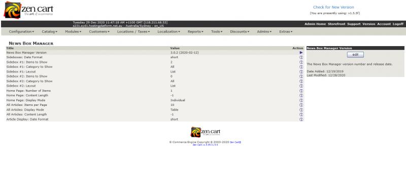

Re: News Box Manager v2.0.0 [Support Thread]
The Admin menu not there!
I am running ZC 1.5.5f, 1st I uploaded a new install of the mod v. 2.0.0 and I followed the instructions to the letter. After uploading he admin section I pressed admin home and the green bar comes across the top to confirm the plugin was installed successfully. I then proceeded to install the includes files when I went to Configuration the Configuration->News Box Manager in not there and neither was the Tools->News Box Manager. So I went to Github and downloaded the master version 2.2.1 and completed the steps again, this time the green bar confirmed the upgrade from 2.0.0 to 2.2.1 was successful. Now only the Configuration->News Box Manager is missing. The plug-in works at least as far as making a news article and I was able to set up the side box but without the configuration I can not use all functionality. What can I do to fix it. Here is the link to my practice site where I uploaded it you will see the side box on the bottom left:http://atmospherebooks.com/webstore2...ain_page=index
sammirah
Nevermind the above message, I found it.
sammirah

Hi Cindy - just some positive feedback - in recently utilizing this plugin and regularly posting home page news there has been a good positive SEO impact in improved search.
So many thanks - anything that improves search is invaluable.
cheers,
Mike
I'd love to be able to 'split' the table to double the number of posts :)
shags38
cheers,
Mike
Mike, thanks for the good-news follow-up! I'm not sure I understand what you mean when you say 'split' the table; could you elaborate?

v1.5.5f news box v3.0.2 www.dazzlerscliponearrings.com.au
Hi Cindy,
I just upgraded from 2.2.1 to 3.0.2 and am having some issues. The primary one is that I am not seeing any news items after clicking the 'latest news' heading [view all] tab (on home page) which takes me to this page /index.php?main_page=all_articles (empty) ..... albeit the link from [view all] is /index.php?main_page=news_archive
Additionally in admin/tools/news box manager [all types] and [type 1] I see my list of news articles and at the end of the row is a series of blue circles under the heading 'action', 4 rows in ALL and 3 rows in Type 1 ... no text inside the circles.
So I 'upgraded' by uploading all files and overwriting all the existing files except tpl_index_default.php which I merged with my existing copy - when I say copied across the only 'difference' and deleted the 'old' code - that resulted in a blank home page (other than header) - so I merged again leaving in the old code, same blank page result .... so now I have just the old code as is, i.e. an unchanged tpl_index_default.php .... see copies of my original and your 3.0.2 copy below.
So the table appears on the home page as it was previously (minus some .css color changes) - I still have 2 articles listed in the sidebox as it was prior to update but they link to /index.php?main_page=article&p=6 [or other number] which again is blank.
In addition to the tpl_index_default.php files please also find a screenshot of my configuration. I have not done something correctly but cannot figure what?
my existing file
* Page Template

v3.0.2 file copy

Attachment 19354
@shags38, a couple of things:
1) The current version of News Box Manager (v3) is v3.0.5.
2) Version 3.0.0 and later support Zen Cart versions 1.5.6 and later (additional notifications/functions added)
Thanks Cindy - I guess I should have read that rather large header at the top of the readme in large letters - for v1.5.6 upwards !! doh!!
