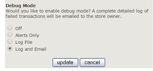

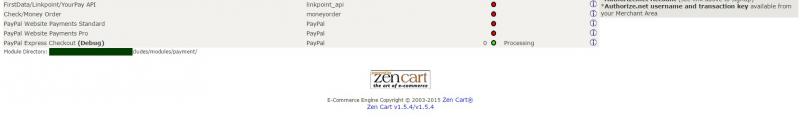

Actually, I only use the Paypal express checkout after fresh Zencart 1.5.4 installation. But don't know why I still get those IPN logs
Attachment 15673
Attachment 15674

You have set the debug mode for email & logs
Set it to off

Will it block ALL IPN notifications (i.e. not only those transaction logs and also real error notification)?
Re: v1.5.4 IPN error logs
I have to remove 18 IPN notification emails for each Ebay transaction. Is it possible to fix this issue?
Yes I am afraid that one can not have it both ways
Either all logs or no logs
