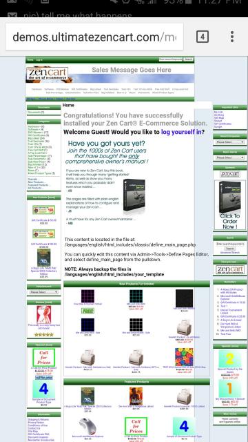

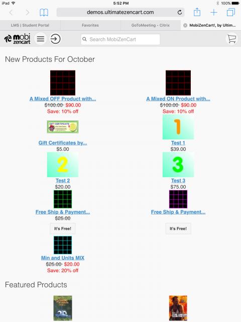

Love the theme, really great:)
If you want to show the theme on mobiles only, no tablets. Replace this code in \includes\templates\template_default\mobile_redirect.php on line 7:
if ($detect->isMobile() && !$detect->isTablet()) {
Re: MobiZenCart with seo url
I'm glad to hear that you like it. Thanks!
As for the code modification. A safer place to ensure that the code only works on small devices such as iPhones would be to change line 41 in includes > init_includes > overrides > init_templates.php from:
if ($detect->isMobile()) {
if ( ($detect->isMobile()) && (!$detect->isTablet()) ) {
Lines 38 to 50 in that file are the ones that change the template for mobile devices.
