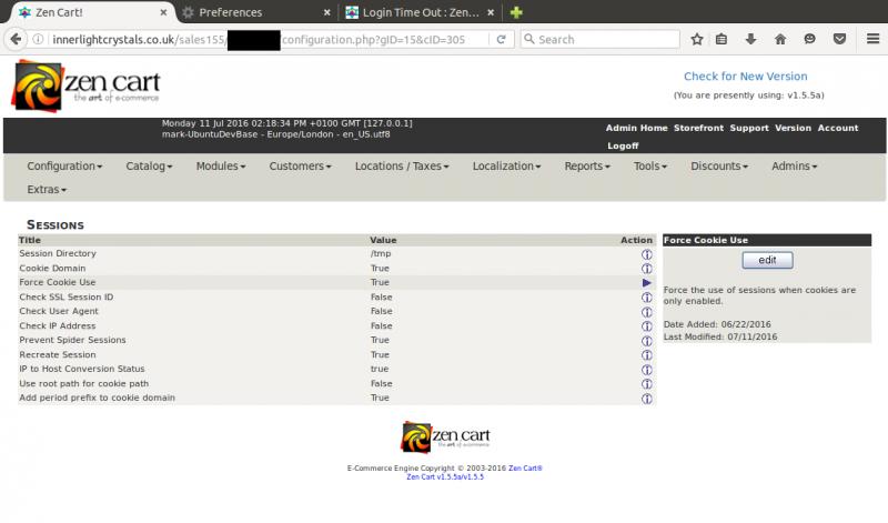

Okay, let's turn on the setting to require cookies: Force Cookie Use = true.
I believe that'll show the "requires cookies" page if they're disabled.
Re: V154 & V155 when cookies off zenid changing with every change of page. add item f
Sorry no change still goes to the time out page when force cookie use is true and cookies are turned off.
Attached picture of settings
Attachment 16479
The difference is that the zenid is not displayed.

I have made the following mod to 155 and it now say about cookies about line 25 in includes>init_includes>init_sanitize.php (same in 154). and turned on force cookie usage in Admin>configuration>sessions.
BEFORE:
$_SESSION ['securityToken'] = md5 ( uniqid ( rand (), true ) );
if ((isset ( $_GET ['action'] ) || isset($_POST['action']) ) && $_SERVER['REQUEST_METHOD'] == 'POST')
$mainPage = isset($_GET['main_page']) ? $_GET['main_page'] : FILENAME_DEFAULT;
AFTER:
if (!$session_started) {
zen_redirect(zen_href_link(FILENAME_COOKIE_USAGE));
The cookies warning now appears when you add to cart and on attempting to logon have not pested beyond that.
