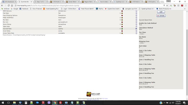

Ok, here are my ZipShip configs: Attachment 17126

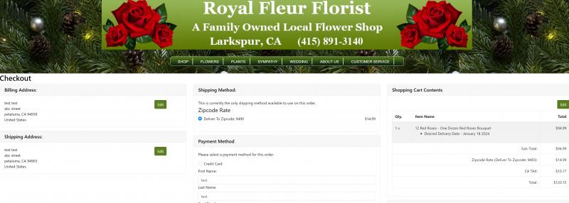

This is what I get at checkout when using it. The zipcode is correct: Attachment 17127
It doesn't seem to be picking up the zip code entered in the shopping cart.
Re: ZipShip - Support Thread
I figured out what the problem was. I had to go into Minimum Values and set the post code length to 5. It was 4. Now the mod is working just fine.

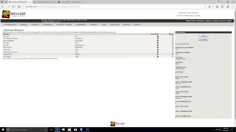

I installed the plugin but i can't get it to work.
I set on zip code in zone 1 as 94939. Set the rate at 10:9.99.
The only option being displayed at checkout is for pickup.
Any ideas what i am doing wrong?
It is on a live test site here at www.royal-fleur.com/wholesale

nicksab
I get a 404 (page not found) when I attempt to view that link.
What is the address that you're using when you checkout? Is it in that 94939 zipcode?
How much does the package weigh? With that setup, up to 10 lbs will be 9.99. Over that, the shipping method is disabled.

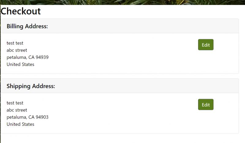

I tried the address with 94939 zipcode in the biling and shipping. I also tried this zipcode in the shipping only.
I don t have any weight specified on any of my product. I am selling flowers arrangement on an items basis so there is no fixed weight. Could this be the problem?

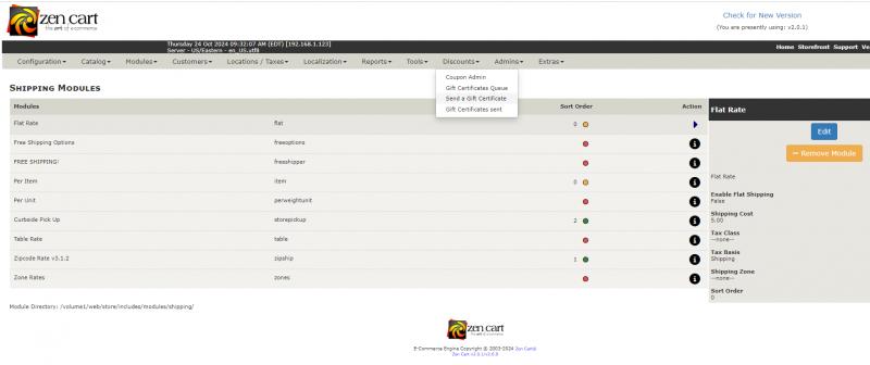

I am using zipship (zone 1) for Store Pickup by inserting zipcode that are allowed to use Store Pickup.
I also set zone 2 to 00000 for all 5 digits zip codes (I believe that is what I read) and that does not work. I also noticed that if I change Shipping Zone from none to the zone code choice the zipship module does not work at all. Change it back and Store Pickup works.
When I using Flat Rate module it will work if Shipping Zone is set to none. If you change it to the choice available it will not work.
This indicates to me that Locations/Taxes is not set up correctly. It is still set as it was before upgrading to 1.5.5e

ZC 1.5.7 with one page checkout and Bootstrap.
For the love of ..., I can't get it to work.
I set my zones as follow:
Zone 1 Zip Codes
94939
Zone 1 Shipping Table
9999:9.99
Zone 1 Handling Fee
Zone 2 Zip Codes
94901,94903,94904
Zone 2 Shipping Table
9999:12.99
Zone 2 Handling Fee
Zone 3 is blank
I am getting the "Sorry, we are not shipping to your region at this time." no matter which zip codes i try.
If i set zone 3 like this
Zone 3 Zip Codes
Zone 3 Shipping Table
999:14.99
Zone 3 Handling Fee
The shipping default to $14.99 no matter which zip i enter in the shipping address.
I am no getting any errors logs or anything.
What am I doing wrong? Any help on figuring this out would be appreciated?
P.S: I noticed the zip code gets truncated in the shipping method box and shopping cart. (i.e: Deliver To Zipcode: 9493).
If i change the delivery address zip code on the checkout page from 94939 to 94903 , the Zip Code display in shipping method changes but the zip in the shopping cart box remains to 9493.
Attachment 20453
Attachment 20454
Attachment 20455
Set Configuration :: Minimum Values :: Post Code to 5 (it defaults to 4).
wow now i feel really "dumb" and want to go hide in a deep hole. :bangin:
Thanks lat9 for rescuing me as always
nicksab
Happy to have helped. I'll note that I ran into this in the initial update for the shipping module as well!

So if I understand correctly, these logs are generated because if the billing/shipping address zip entered does not match the one i specified and the message appears.
hypothetically, if we don t serve zip code: 11111, the error logs gets generated and the " not available at this time" get displayed.
So that could be confusing to customer.
How can i do this instead: If the zip is outside of our serving area, a message is displayed asking customer to check shipping address in order to continue??
the best would be to have the shipping address separate from the billing address instead of being "auto fill". (if that makes sense)
I look into this option at some point but was never able to figure it out.

I've been using this amazing plugin for a few years and in the process of getting latest version to work with ZC 2.0.1 on my test site. Can't get it to appear as a shipping option and there are no error logs.
Attachment 20777
Any suggestions of how to troubleshoot?
allmart
Attachment 20777
Er, it's showing up as the next-to-last shipping module in that screenshot.
Sorry for being unclear, it is not appearing at checkout as a shipping option
The shipping module will only show up on the storefront when the ship-to zipcode is present in the module's configured list.
