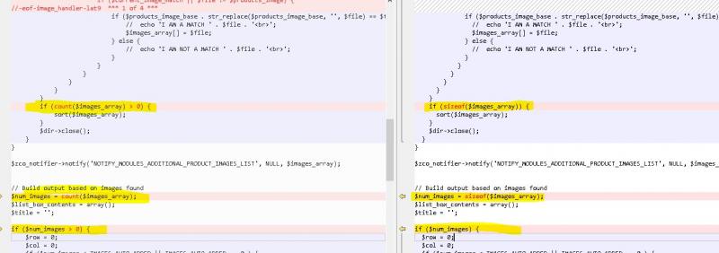

For some reason my template not showing additional images; here is my template code:
require(DIR_WS_MODULES . zen_get_module_directory('additional_images.php'));
if ($flag_show_product_info_additional_images != 0 && $num_images > 0) {
/*if($prodinfo_image_effects==2){
unset($list_box_contents[0][0]);
$list_box_contents[0] = array_values($list_box_contents[0]);
for($row=0;$row<sizeof($list_box_contents);$row++)
$params = "";
//if (isset($list_box_contents[$row]['params'])) $params .= ' ' . $list_box_contents[$row]['params'];
for($col=0;$col<sizeof($list_box_contents[$row]);$col++)
$r_params = "";
if (isset($list_box_contents[$row][$col]['params'])) $r_params .= ' ' . (string)$list_box_contents[$row][$col]['params'];
if (isset($list_box_contents[$row][$col]['text']['thumb']))
echo '<li' . $r_params . '>' . $list_box_contents[$row][$col]['text']['thumb'] . '</li>';
Re: Image Handler 5 (for v1.5.5) Support Thread
I traced it down to this in includes/modules/additional_images.php this is the code that seems to be the problem:

I used to have Zen Lightbox installed but I'm working on an upgrade to V1.5.5f and I started with a stock install so there will be no remnants of Lightbox left. I have also run the uninstall sql to remove references from my database.
Running PHP Version 5.5.38 and MySQL 5.5.58. If that could be playing a part? Upgrading my store so I can go to PHP 7.
The site is not open to the outside world yet but I can enable it if needs be. Before I do that does any one have any ideas?
Brent
PS there are slight differences with /includes/modules/MYTEMPLATE/additional_images.php and the stock file. These don't appear to be intentional but wasn't sure. For example line 86:
if (count($images_array) > 0) {
vs
if (sizeof($images_array)) {
line 97:
$num_images = count($images_array);
vs
$num_images = sizeof($images_array);
line 101:
if ($num_images > 0) {
vs
if ($num_images) {

My pleasure. Thanks to you I'm pleased to confirm all is now working. :clap: It also highlighted the fact I had a lot of other junk in the database left over from uninstall scripts that only partially worked.
When you are next looking at the mod can you check:
Should the changes in the stock file be pulled across? I posted the snippets above but see my screen shot which is easier to view.
Attachment 17733
Brent
Both code-bits provide the same function; the ones in IH5 are currently more "recent" and specific than those in your "stock" file.
Thank you. Your code it is then.
I did tried both versions and they both seemed to work but I like to sort things like this out as if ignored they have a habit of coming back to bite you years later.

creyesx6
Yes, so I am nearly there. The large images are working exactly as needed. However after updating the catalog I found that products with multiple images are not displaying on the product info page. I just have a blank image. I am using IH 5 with 1.5.5+.
Here is a url to show what is happening with multiple images:
http://bellafurnitureandmattress.com...nton-p-14.html
I noticed when going to the Image Manager to check this product that the medium image has a - only without an image. Images were added via FTP and Easy Populate 4.
Thanks for the plugin and help!
There's apparently something awry with the merge/update that you made for the /includes/modules/alto/additional_images.php, since no images are being populated. Remember that the Alto theme started out with IH-4, which needs to be fully replaced for IH-5 to operate properly.
Yes! Absolutely right. The template is now updated with IH5.
