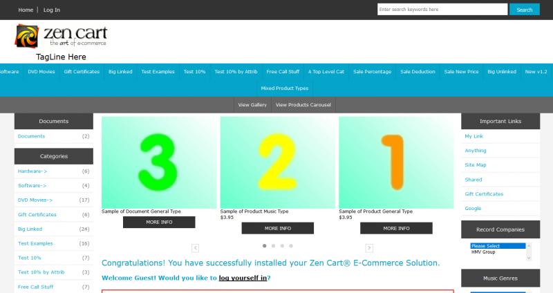

This is the official support thread for the ZX Home Page Products Carousel plugin.
For those who want to download it before it is approved and available in the Plugins section, you can find it here.
The official plugin download is here
The plugin allows you to add a rotating slider to your home page and automatically display your latest products, specials, featured, bestsellers or simply a custom list of products.
Attachment 17903
