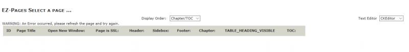

So here is where I am:
Completely upgraded to 1.5.6
Mutilingual ezPages Plugin Completely Removed down to the last file.
admin/ezpages.php - deleted and replaced from a fresh copy of ZC v. 1.5.6
The result: Site is starting to resemble itself, and I have access to EZPages in my admin area again although no files are showing just getting an error.Attachment 18209
And the following:
myDEBUG-1545529210-146604.log ( ASCII text, with CRLF, LF line terminators )
[22-Dec-2018 20:40:11 America/Detroit] Request URI: /webstore2/index.php?main_page=index, IP address: 23.243.5.141
#1 trigger_error() called at [/home/sammirah/public_html/webstore2/includes/classes/db/mysql/query_factory.php:171]
#2 queryFactory->show_error() called at [/home/sammirah/public_html/webstore2/includes/classes/db/mysql/query_factory.php:143]
#3 queryFactory->set_error() called at [/home/sammirah/public_html/webstore2/includes/classes/db/mysql/query_factory.php:270]
#4 queryFactory->Execute() called at [/home/sammirah/public_html/webstore2/includes/modules/sideboxes/ezpages.php:26]
#5 require(/home/sammirah/public_html/webstore2/includes/modules/sideboxes/ezpages.php) called at [/home/sammirah/public_html/webstore2/includes/modules/column_right.php:32]
#6 require(/home/sammirah/public_html/webstore2/includes/modules/column_right.php) called at [/home/sammirah/public_html/webstore2/includes/templates/becaberry/common/tpl_main_page.php:159]
#7 require(/home/sammirah/public_html/webstore2/includes/templates/becaberry/common/tpl_main_page.php) called at [/home/sammirah/public_html/webstore2/index.php:97]
[22-Dec-2018 20:40:11 America/Detroit] PHP Fatal error: 1146:Table 'sammirah_zenc945.zen_ezpages_content' doesn't exist :: SELECT e.*, ec.*
FROM zen_ezpages e,
zen_ezpages_content ec
WHERE e.pages_id = ec.pages_id
AND ec.languages_id = 1
AND e.status_sidebox = 1
AND e.sidebox_sort_order > 0
ORDER BY e.sidebox_sort_order, ec.pages_title ==> (as called by) /home/sammirah/public_html/webstore2/includes/modules/sideboxes/ezpages.php on line 26 <== in /home/sammirah/public_html/webstore2/includes/classes/db/mysql/query_factory.php on line 171
and
myDEBUG-adm-1545533775-417078.log ( ASCII text, with very long lines )
[22-Dec-2018 21:56:16 America/Detroit] Request URI: /webstore2/zcadmin/ezpages.php, IP address: 23.243.5.141
#4 queryFactory->Execute() called at [/home/sammirah/public_html/webstore2/zcadmin/includes/classes/split_page_results.php:40]
#5 splitPageResults->__construct() called at [/home/sammirah/public_html/webstore2/zcadmin/ezpages.php:536]
[22-Dec-2018 21:56:16 America/Detroit] PHP Fatal error: 1146:Table 'sammirah_zenc945.zen_ezpages_content' doesn't exist :: select count(*) as total FROM zen_ezpages e, zen_ezpages_content ec WHERE e.pages_id = ec.pages_id AND ec.languages_id = 1 ==> (as called by) /home/sammirah/public_html/webstore2/zcadmin/includes/classes/split_page_results.php on line 40 <== in /home/sammirah/public_html/webstore2/includes/classes/db/mysql/query_factory.php on line 171
So, I have checked phpMyAdmin hoping to find the highlighted zen_ezpages_content table to no a avail. So how should I proceed do I just make a table and call it that. I am at a lost on how to proceed.
and
So, I have checked phpMyAdmin hoping to find the highlighted zen_ezpages_content table to no a avail. So how should I proceed do I just make a table and call it that. I am at a lost on how to proceed. BTW all of this is on my test site, so my active site is still working well on 1.5.5f
