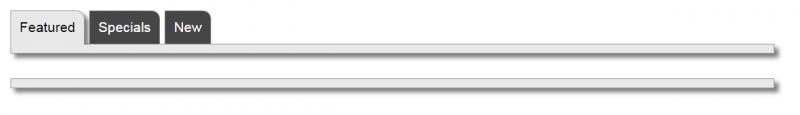

That helped but now Featured Products tab does not work correctly.
Attachment 19458
Re: Seasonal Centerbox [support thread]
tedjmaines
Silly Me..... so much for programming late at night.........
Attachment 19458
Still having issues with Seasonal Centerbox stopping Feature from displaying. See previous post.

I could use some help .
The modules was working fine then i switch categories to 0 to disable the module for awhile.
I switch it back to categories 48 for example, however, i am getting a blank frame.
I tried to remove and reinstall the plugin but no luck.
It is on the main page of royal-fleur.com right above the deal of the week section.
Anyone know how i can fix this?
thank you for your help.
