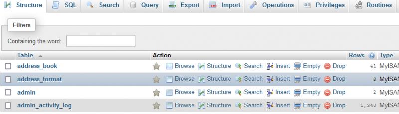

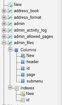

Those would appear to be related to tables added by something other than original Zen Cart.
Does the output show the table names too? Or clues to what table it was operating on before/after the errors appeared?
I'm puzzled how an existing table could have double auto-increment fields already, so that's odd.
As far as duplicate key name, that's also a bit odd since normally that wouldn't ever have been allowed. I suspect it got created by phpMyAdmin in times past when you attempted to manually add an extra index to a table.
If there's no other output on-screen that can help identify which table, then you could look at your backup file for all the CREATE TABLE commands, and see which tables have more than one auto column, and which ones have any indexes named "id". Then with that information we can come up with whatever manual fixes are required for tidying up these inconsistencies inherited in your old database.

Hello. I updated an older zen using the upgrade button during zc_install. The previous version worked fine with no warnings or loss of functionality. That being said, i never ran the php program on the previous zen verions to know if these problems existed. I never added a table or toyed with the phpadmin. I did start out, years ago, by hiring a person who may have started me out on a bad premise?
Anyway, as soon as i find the time I'll attempt to provide the info. I'm upgrading a second store now. we'll see if the problem repeats itself. old store is fine. no problems at all. I'm being warned by the host that i need to update the php so, now i'm doing the upgrade to the 1.5.7c.
Re: Some issues when upgrading
Dr Byte, I'm having a heck of a time trying to provide you what you've asked for. I brought it up with bluehost and they told me to import into a new database. they then dropped the tables and imported it again and said, it's fixed...said the database was not able to overwrite itself. they did all this on test databases and i have no way to confirm as i cannot run the php program without setting up a new cart, right? If that's true... what would cause a database to stop overwriting itself? eh... in your estimation, can i live with this? It's a business i need to put food on the table. so, there's that. should i fix it? will it cause problems later on? is there a risk? Time is the problem. But will make the time if you think it's important enough. It is a database after all. thank you

When you say "dropped" you mean, gone? I went into myphp admin and took a snap shot of this area and expanded it. there are two images included here of what i'm talking about. See images. Dropped means these should Not be there? Attachment 19626Attachment 19627
muah
I wonder if in the past you installed the Admin Profiles add-on (https://www.zen-cart.com/downloads.php?do=file&id=12), a quick look shows that it creates the admin_files table with the same columns as in your image. Given that (as the link shows) this functionality was subsequently built-in to ZCv1.5.x, then as @mc says it would appear that the table can be dropped/deleted. Within phpmyadmin you can see there's a 'drop' link next to the relevant table, here's a shot of part of mine:
Attachment 19628
Of course, backup your database first.
Attachment 19628
I have a faint recollection of such an install. Not sure. I deleted the table and ran the utf8 converter again and this time without errors. Thank you.
