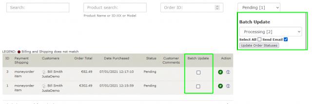

Mod - Batch Order Update, for Zen Cart 1.5.7.
This mod is for the Admin, Order listing page. It is multi-language.
When an order status filter is selected:
1) A checkbox is added to each order to allow multiple selection multiple selection.
2) A dropdown is displayed to select the new status for the selected orders.
The orders can be updated in one action, emails can be optionally sent.
Attachment 19664
How it works
The list of orders and their languages is stored in an array and updated one-by-one using redirects and the language parameter to send each email in the order language.
When complete, the admin language is reset to it's original language.
Clumsy, slow, inefficient...but until the whole order email process is reworked, it will have to do. But it works.
Get it here:
https://github.com/torvista/Zen_Cart-Batch_Order_Update
Use GitHub to see what happened and when. Use a Github client to keep up to date. I use GitKraken.
After downloading, use GitHub to see what happened subsequently and when. Use a Github client to keep up to date. I use GitKraken.
Report errors on GitHub as they should be temporary and here they only clutter up the thread.
If someone wants the challenge to make it look pretty/fit well into the responsive structure, go right ahead!

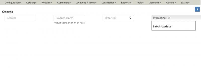

I installed on my test server 1.5.7c 7.4 php - also running Comment Boiler plate
merged the 2 orders.php files and when I select a status to filter, the page displays as follows:
Attachment 19695
and here is the error log... not sure what to trace.
HTML Code:
[31-Jul-2021 04:14:29 UTC] PHP Fatal error: Uncaught Error: Call to undefined function zen_draw_order_status_dropdown_batch_update() in /admin/orders.php:635
Stack trace:
#0 /admin/index.php(11): require()
#1 {main}
thrown in /admin/orders.php on line 635
[31-Jul-2021 04:14:29 UTC] Request URI: /XXkcaz00/index.php?cmd=orders&status=1, IP address: xxxxxxxxx
--> PHP Fatal error: Uncaught Error: Call to undefined function zen_draw_order_status_dropdown_batch_update() in /admin/orders.php:635
Stack trace:
#1 {main}
thrown in /admin/orders.php on line 635.
Re: Batch Order Status Update
Fixed... got lost in the forest of comparisons between versions.
