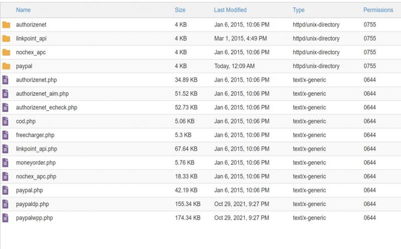

These are the files I have in includes/modules/payment
Attachment 19782
Re: Paypal Payment options disappeared from admin menue
toyseller
For those not sighted:
authorizenet.php
authorizenet_aim.php
authorizenet_echeck.php
cod.php
freecharger.php
linkpoint_api.php
moneyorder.php
nochex_apc.php
paypal.php
paypaldp.php
paypalwpp.php
I expect at least linkpoint_api.php to be a problem. There may be trouble with other modules, but linkpoint_api.php has specifically been identified as not compatible in future versions with higher php versions and even if/when modified for compatibility, the payment module was removed because it was not going to be further supported.
Recommendation is to remove includes/modules/payment/linkpoint_api.php and the accompanying language file(s) associated with it: includes/languages/english/modules/payment/linkpoint_api.php
That should either restore the admin modules payment window or at least provide more items in the list. If not, then check the error logs again looking at the myDEBUG-adm file(s) most recently created to see what issue(s) are identified. Note that the file will contain your admin directory name which really should not be shared publicly.
Wow ... I renamed the linkpoint files ... and the paypal options have reappeared !!!
Attachment 19787
Also getting this ...
Attachment 19788
You've got an additional script loading (jscript_lazy.js) that's got a syntax error.
Yes, I know ... and I cant fix it.
