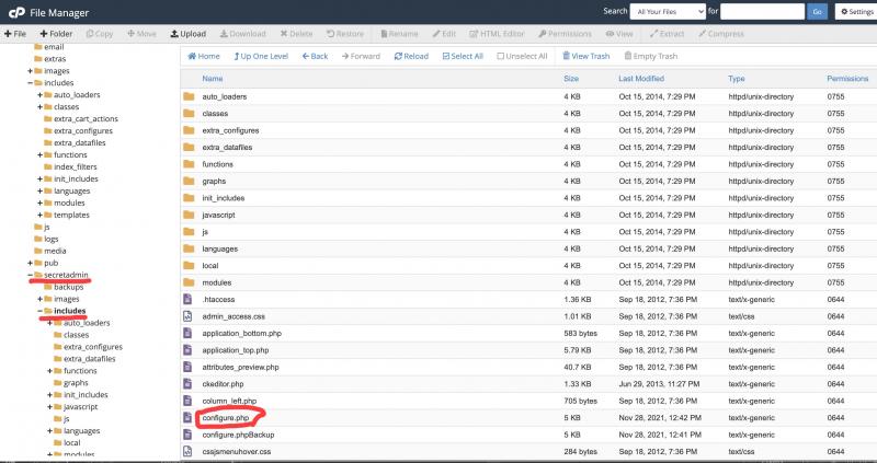

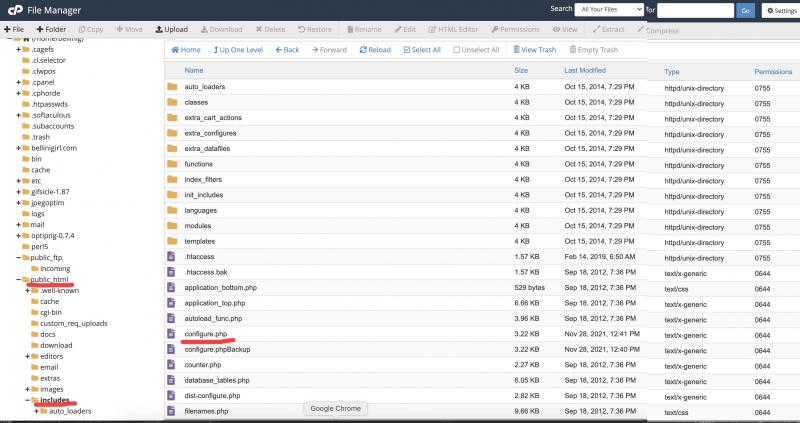

and I THINK I found them but not sure so I want to paste screenshots of the file path in my cpanel and hopefully get feedback from you very smart people before i do it.:smile:
Attachment 19846
Attachment 19847
Hopefully you can see these.

You found them! Now, also change the name (if you didn't already) of your secretadmin!
