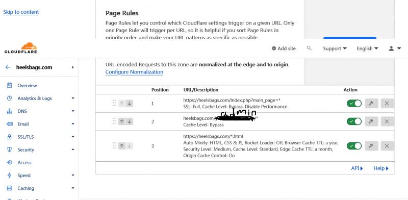

ok i did it and test again,but maybe it can't login up and checkout , it always goto https://heelsbags.com/index.php?main_page=cookie_usage
"We have detected that your browser does not support cookies, or cookies have been disabled."
Re: Can anyone help me solve the plugin error problem?
Would you post a screenshot of the site's Configuration :: Sessions settings? Since there was one non-default setting, perhaps there's another that's causing that cookie required page.
If you have a test account-login that you can share with me, send me a PM with that information.

with cloudflare information
Attachment 20357
ok,i have set the cloudflare again,and maybe it work now,but i hope you help me to test ,beacuse i don't know if have any other question,but there have an problem for cart,the cart don't upgrade when click "add to cart"button,and it don't upgrade when goto cart(https://heelsbags.com/index.php?main...ping_cart),you must enter F5 to Refresh(or click refresh botton).

any one help me to check and perfect please.thanks

Ok,Thanks,i have did it,but the cart don't upgrade when add some products to cart.
