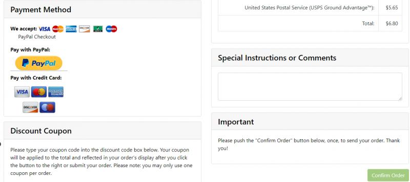

Guest checkout, first test after configuration, clicked PayPal button... no checkbox/radio button seems very confusing with the express button on the checkout/payment page. The button is clickable, but goes no where.
Attachment 20448
So I click it, then confirm order and it fails to the following page & error.

There is still no radio/checkbox for the payment module. Noting it is the only payment displaying.
~Melanie
There is no radio/checkbox for the module since you've only got that one payment module installed. I'll rethink the means of identifying which (PayPal vs CC) sub-option is selected, but IMO using a radio/checkbox for the sub-option is ugly.
Re: PayPal RESTful API Payment Module

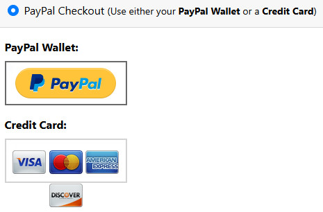

Maybe a selected state behavior, like a border? and the credit card one doesn't look at all like a selectable option, would need "buttonized" or something
I've just created a GitHub PR with some UI improvements (https://github.com/lat9/paypalr/pull/3), if you'd like to see before the next beta release.

ZCA Bootstrap Template v3.6.5
The zoom in/out setting of my browser is 100%, but the Discover Card logo isn't in the same row. Is there any setting I can adjust in this module?
siliconbug
Attachment 20607
You'll need to provide a template-override for the payment-module's .css file. Copy /includes/modules/payment/paypal/PayPalRestful/paypalr.css to /includes/templates/YOUR_TEMPLATE/css/paypalr.css and then edit this section:
.ppr-button-choice label {
cursor: pointer;
height: 2.5rem;
font-weight: bold;
width: 11rem;
display: inline-block;
text-align: center;
to adjust the width. It looks like 15rem should work.
I copied /includes/modules/payment/paypal/PayPalRestful/paypalr.css to /includes/templates/bootstrap/css/paypalr.css and then changed the width to 15rem or bigger number, but nothing happened.
Attachment 20610
siliconbug
Attachment 20610
My bad. Since you're using the Bootstrap template, copy the paypalr_bootstrap.css file and make the changes there.
