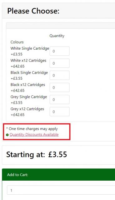

Rebuilding an old site on the latest Zen and php8. Is it possible to hide these 2 lines that appear in my attributes box?
Attachment 20665
This didn't appear on my zen 1.3.6 store and I cannot figure out how to remove those 2 lines in the red box.
AFAIK I am not using any kind of discount pricing for products or attributes and when you click this link an empty popup appears.
Check your attributes to make sure... bc that's weird. If you're not using it turn it off in Configuration >> Attribute Settings

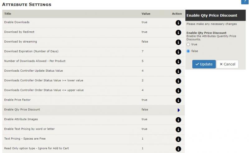

I tried setting 'Enable qty price discount' to false in the attribute settings but the line still shows whenever a product has attributes set.
Like Melanie indicated, check also the product's attributes to make sure that there aren't attribute-level quantity discounts set up.

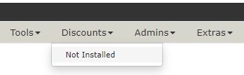

as far as I can tell there are no attribute level discounts set up, but for clarity; when setting up attributes should I be adding my price to the 'prefix price' box or the 'one off' box? Currently all of my attributes use the prefix price + include base price (but the base price is always zero if there are attributes for a product).
Attachment 20700
Attachment 20701
Attachment 20702
Attachment 20703

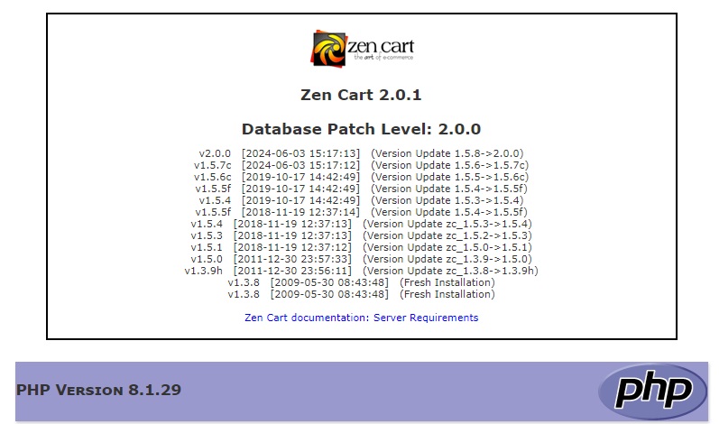

Interesting; what version of the Bootstrap template? Just to verify, you're running your upgrade on Zen Cart 2.0.1, right?
Re: Hide 'quantity discounts available' link?
Template Name: "ZCA Bootstrap-4"
Template Author: rbarbour (zcadditions.com), lat9 (vinosdefrutastropicales.com), drbyte (zen-cart.com)
Template Version: Version 3.7.0
