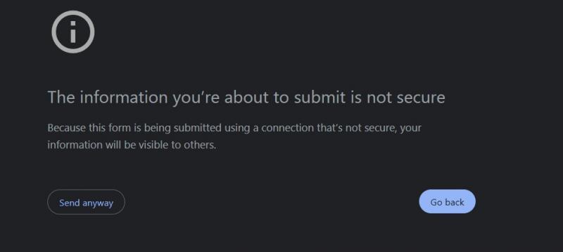

Hmm this is super odd, maybe at the root of the problem. If the cert is good, why would this be insecure?

I did the built in demo and see the same thing happen there. This feels like this is at my hosts level.
If I'm running PHP 8.1 will this create this insecure error?
Re: Admin And Checkout Throw 500 Error
It has nothing to do with the PHP version.
Check includes/configure.php and be sure all the URL entries (HTTP_SERVER and HTTPS_SERVER) have values that start with "https://"

Keeps feeling like the problem is on both hosts when I go to submit when its not HTTP it shows insecure errors each time I have to click but on HTTPS it shows a 500 error. SSL cert is clearly in place, I have changed HTTPS in both those fields, and I have SSL turned on in configure.php. Not sure how much more I can do and it is super frustrating that I'm not up with the new host.

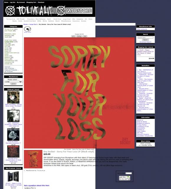

Attachment 20792
FYI this is the image problem at this point. Again old templating/CSS issue somewhere.
Copied stylesheet_image_modals.css and stylesheet_image_modals.php into my template and that fixed that! Thanks for having my freak out on here and helping me. Still so confused why I needed to do all this.
