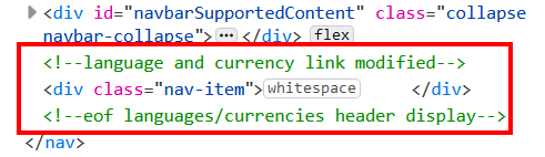

Perhaps I'm doing something wrong, but I tried the latest on a test Bootstrap site, and there's nothing being displayed in the header.
It looks like the code is there, but no output is displayed because it's nothing but white-space.
I am attaching two screenshots. The first shows that nothing is displayed (I highlighted it with a blue box). The second shows the page source where you can see the output block is there but only white-space is noted where the content should be.
Attachment 20411
Attachment 20412
Any ideas why that's happening?
Re: Language/Currency Links in Header

Just to check, you need at least two languages/currencies installed for this to work. Actually used language/currency is not displayed.
It looks like something is missing. Did you installed files in template_default, they are necessary.
The only problem I found that still need to be fixed is color diplay for currencies. Default is blue (link) and does not go well with dark background.
Okay, thanks for the clarification. I was under the assumption that the plugin itself would offer a dropdown list of translations and currencies. I wasn't aware that it relied on what already preexisted from the store. Now it makes sense why nothing was displayed, because we currently only have one currency (USD) and one language file (English).
