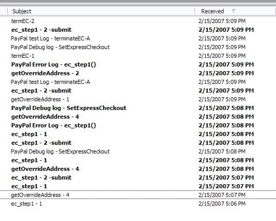

I am also having the same problem... I went through the logs I had it send me and from what I can tell it checks all orders that my Test account has made and its past address's... Not sure if that effects anything.... What patch are you talking about also

USEFUL observations:
1) I have a download-only product and it works just fine
2) The logs show:
Feb-15-2007 06:02:13
before_process - EC-5
resultset:
Array
[ACK] => Failure
[L_ERRORCODE0] => 81210
[L_SHORTMESSAGE0] => Invalid%20Parameter
[L_LONGMESSAGE0] => Country%20%3a%20Invalid%20Parameter
[L_SEVERITYCODE0] => Error
3) Same logs show:
before_process - EC-3
address overrides added:
Array
[ITEMAMT] => 0.01
[SHIPPINGAMT] => 0.00
[AMT] => 0.01
[L_NUMBER0] => 0
[L_QTY0] => 1
[L_NAME0] => GUTS
[L_AMT0] => 0.01
[L_TAXAMT0] => 0.00
[SHIPTONAME] => Andrey Abramov
[SHIPTOSTREET] => 240 Bay Street #410
[SHIPTOSTREET2] =>
[SHIPTOCITY] => San Francisco
[SHIPTOSTATE] => CA
[SHIPTOZIP] => 94133
[SHIPTOCOUNTRY] =>
My best guess is that SHIPTOCOUNTRY used to be empty by default and now PayPl requires an explicit value.

This is a screen shot of all the emails I received when I had "log and error debug" turned on in admin->modules->payment->paypal express checkout. These are all the emails I received in two failed transactions that generated the invalid parameter error.
If you tell me which of these to post (if any) I can :) Sorry for doing this in such an "zen for dummies" way but it's the only way I know how to make sure I'm doing exactly what you're telling me to do
http://img.photobucket.com/albums/v6...s/bugerror.jpg
Re: Help? (Invalid Parameter)?
CafePrima
Ideally one that says "ec_step2_finish - 1" or "PayPal Debug log - GetExpressCheckoutDetails" would be most useful.
I'm sorry-it doesn't look like I have any of those that you requested. Which is odd because I was getting the error in question!
