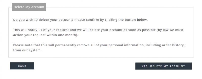

I've given some thought to how to implement the 'right to be forgotten'. Some years ago Kuroi highlighted a potential fraud issue with allowing customers to delete their own accounts. So given that I'm unlikely to have to deal with many account deletions I've gone down the road of having a customer request that their account be deleted - click on a button and it sends me an email requesting such. In case anyone's interested:
I added a link in the customers Account page (\includes\templates\my_template\templates\tpl_account_default.php) pointing to a 'Delete My Account' page.
I created 3 new files:
\includes\languages\english\my_template\account_delete.php
\includes\templates\my_template\templates\tpl_account_delete_default.phpCode:define('HEADING_TITLE', 'Delete My Account');
define('NAVBAR_TITLE_1', 'My Account');
define('NAVBAR_TITLE_2', 'Delete Account');
define('TEXT_SUCCESS_ACCOUNT_DELETE', 'Your request for your account to be deleted has been successfully sent and will be actioned as soon as possible.');
define('ACCOUNT_DELETE_INFORMATION', 'Do you wish to delete your account? Please confirm by clicking the button below. <br/><br/>This will notify us of your request and we will delete your account as soon as possible (by law we must action your request within one month).<br/><br/>Please note that this will permanently remove all of your personal information, including order history, from our system.');

\includes\languages\english\my_template\button_names.php
All this gives give meCode:define('BUTTON_CONFIRM_DELETE_ALT', 'Yes, Delete My Account');
Attachment 17789
A click on the button gives a 'message received and understood' page and an email is sent to the address in the admin > configuration > e-mail options > Email Address (sent FROM) field.
This is just a copy and paste job (so there are probably plenty of errors/omissions/redundant code).
