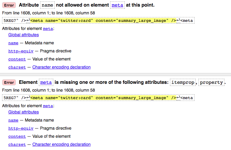

Hi there!
I am very happy with your "Structured Data Markup for Schema" but there are ERROS with the html-validation:
Attachment 18278
Attachment 18279
I did not find any info/solution for this problem - any idea?!?!
Greetings :)

Re: Structured Data Markup for Schema, Facebook Open Graph, Twitter...
meta tags are supposed to be in the head section of the page, not sure why yours are at the bottom of the page in the body section.

quite right, that's your problem:
You are using the css/js minifier, which in the newer versions loads all java script files at the bottom of the page. As you discovered, this is not always a good thing. YOu need to edit your code, so it does not load the jscript_plugin_structured_data.php file in the footer.

Design75
Thanks a lot for your feedback - ok, I thought bout that - so just like that? I put the code into the header of file "html_header.php" ?!?
<?php require($template->get_template_dir('jscript_plugin_structured_data.php',DIR_WS_TEMPLATE, $current_page_base,'templates'). '/jscript_plugin_structured_data.php'); ?>
or should I use something like this?
<script src="<?php echo $template->get_template_dir('',DIR_WS_TEMPLATE, $current_page_base,'jscript') . '/jscript_plugin_structured_data.php' ?>" type="text/javascript"></script>
And if I do it, the minifier does not fetch it after because it is already used it the head-section...am I right with this?
Once again, thanks a lot for your answere, very helpful for me :)
Since I have moved the general jscript calls manually to the footer, this is exactly what I have in my html_header.php
<?php //steve structured data - contains meta tags for facebook so has to still be in the head
include (DIR_WS_TEMPLATES . $template_dir . '/jscript/plugin_structured_data.php');
Note the script is not named "jscript..." to stop it being auto-loaded in the footer with all the other scripts that are named "jscript...".
torvista
Note the script is
Damn GREAT - it worked - many many thanks!!! I am happy now :)
i did the same but did NOT delete 'jscript'plugin_structured_data.php ... without jscript everything is fine!
once again - THANKS a LOT!!!
