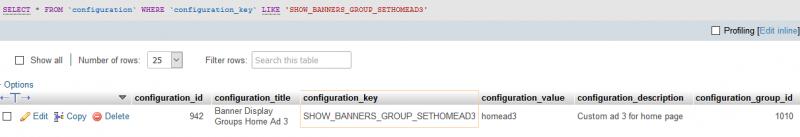

Yes, you've been looking in the Banners table, the additional database information needs to be in the Configuration table, if I search that table for SHOW_BANNERS_GROUP_SETHOMEAD3 I can see this:
[can't seem to attach an image at the moment]
So you need to create a new line(s) with SHOW_BANNERS_GROUP_SETHOMEAD4/5/6 (possibly easiest to copy an existing line and edit that), you should then see the the entries in Admin > Configuration > Westminster New Template Configuration and hopefully all should be well.

simon1066
Attachment 18936
Managed it this time.

You need to be careful doing the database edits, the configuration_group_id should remain unchanged with the configuration_id being a unique number. I think that is the way to do it. Back up your database, if I've given the wrong advice hopefully others will chime in.

Hi Simon,
your snippet was worth it as it had the info i needed to track down the banners, which are all working now... brillant.
