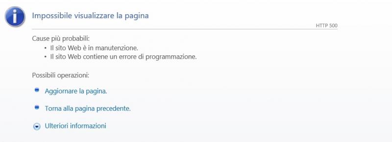

I found another selector that generates an error maybe you are already aware of it if it is so sorry,
if I select true
Attachment 19017
I get as in the photo
Attachment 19018
I think I have tried everything, I hope I have not missed anything else, the rest is all ok.
