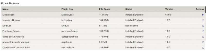

a screenshot of one of my clients zc_plugins modules (most of which are not available for public download):
Attachment 19710
