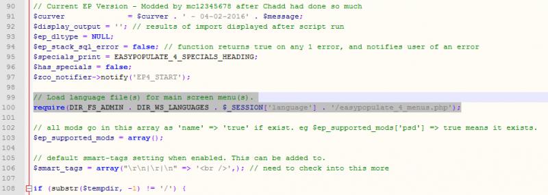

    The first time when I access .../easypopulate_4.php, it show this.
    Then I edit easypopulate_4.php and remove line 100.
    And the pages is working now.
    What wrong actually? Any solution to solve this other than I remove line 100?

    The first image didn't provide any useful information to diagnose the problem, but having removed the require for the language file and seeing the results of removing the language's load line, it would appear that you're missing the language file in the admin/languages/YOUR_LANGUAGE/ directory...
    Also, the code could be written to check for the existence of the language file and if not found default to the English language like other aspects of ZC. I'll add that to the list of changes for the next change.
