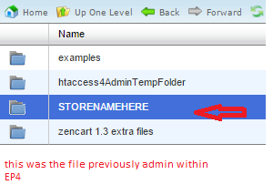

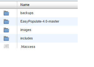

    I think that's where I have them, if you look at the images I have attached above, then I renamed the directory called admin contained within EP4 to match the store name.
    Is that where I have gone wrong because nothing shows up in zen CP under tools
    I can't understand your images.
    Is easypopulate_4.php at STORENAMEHERE/zenadmin/easypopulate_4.php ?
    If not, then you're putting things in the wrong place.
