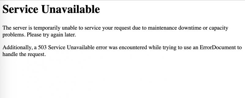

    Friends, I'm using version v1.5.5e. (yeah, I know...) but I have like 50 sites and upgrading is going to be a massive undertaking, so I'm still there. Until a few days ago, this mod worked perfectly, has worked perfectly for years. Now I'm getting this error each time I choose "easy populate 4" from my tools menu:
    Name:  Screen Shot 2023-02-02 at 6.43.56 AM.jpg
    Any ideas what may have changed on my hosting server perhaps? This behavior is consistent across ALL of my sites, and has been this way for several days. Everything else is working fine on the site.

    Quote Originally Posted by cindygordon View Post
    Check, or ask you host to check, modsecurity rules. They have have been updated. A 503 error will happen if modsecurity is blocking the action. There are, of course, many other reasons for a 503, but I have seen this happen.
    Check your logs directory to see what if any debug logs were generated while attempting access. If posting the content here, remember that the admin directory will be present and should be obscured.
    Also, if the housing company for all sites is the same, they may be having a particular issue besides s what was previously suggested.
