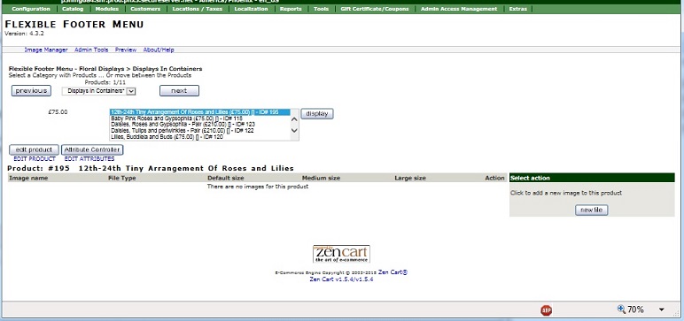

IH4 just stopped working??
Everything was working fine and now I can't get into IH, just get a message that says "No Image Handler information found"
In addition, can IH4 be re-installed without uninstalling? If IH4 is uninstalled and re-installed does that mean I would loose all my current product images?
Version in Zen Cart plugins section has NOT been updated to work with v1.5.4. Search the thread for the beta version in Github.. Still waiting for feedback from testers before releasing..
IH4 doesn't do anything to the original image files.. (which is clearly stated in the readme file..)

Unfortunately upon further inspection it does look like I've screwed something up as I'm no longer seeing the images under image handler, was previously. Have tried your uninstall script again and reupped 4.3.4. Still no luck, if you have any ideas would be extremely appreciated or worse comes to worse I'll restore the backup of the test site.
Thanks again.![]()
Was thinking that rather than wasting time trying to dissect, just restored and installed IH 4.3.4.
All working fine, thanks again for the plugin.
