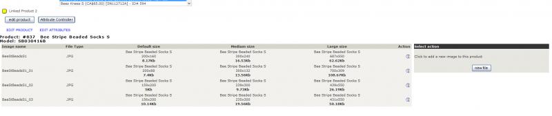

    When I updated my live site to zc 1.5.5a I lost the images that appear in admin/tools/IH4(4.3.2) - the small imgs that appear when you add extra images to your product. I updated my wamp test site first and did not encounter this problem. I uninstalled IH4 from test site, and installed IH4.4 most recent github file set. No problems. Did same with live site and the no small img on admin page persists.
    The images all show properly in the store, and on the admin page the names of the files added show, just not the actual image.
    I confirmed that the small image exists in the bmz cache folder. And looking at the source code for the IH admin page in live site, compared to test site - everything is identical except the img file names and folders that are specific to each. I was using the .htaccess file that was in the 4.3.2 file set, and now the updated version.
    Could this be a permissions issue? And/or any idea which folders I would look at. Or does this sound like some other issue?
    Name:  screenshot-server10 camelot-hosting com 2016-05-18 10-21-52.jpg

    If you view the source of the page, what does the path look like for your image(s)? (remember to obscure your admin directory if it is included.)
    Also, may want to post your admin/includes/configure.php obscuring your dB credentials and admin directory if present.
    <!-- Start Photo Display -->
        <h4>
          Product: #287&nbsp;&nbsp;Aloe Vera 27  S      <br />Model: SN102709A          </h4>
        <table border="0" width="100%" cellspacing="0" cellpadding="2"><tr><td valign="top">
        <tr class="dataTableHeadingRow">
          <td class="dataTableHeadingContent">Image name</td>
          <td class="dataTableHeadingContent">File Type</td>      <td class="dataTableHeadingContent" align="center">Default size</td>
          <td class="dataTableHeadingContent" align="center">Medium size</td>
          <td class="dataTableHeadingContent" align="center">Large size</td>
          <td class="dataTableHeadingContent" align="right">Action&nbsp;</td>
        </tr>
    <tr class="dataTableRow" onmouseover="rowOverEffect(this)" onmouseout="rowOutEffect(this)" onclick="document.location.href='https://serverxx.camelot-hosting.com/xxxxxxx/xxxxxxx/image_handler.php?products_filter=287&amp;imgName=MN102709A&amp;action=layout_info'">
          <td class="dataTableContent">MN102709A</td>
          <td class="dataTableContent">.JPG</td>
          <td class="dataTableContent" align="center" valign="top">
            <img src="/bmz_cache/m/m-mn102709ajpgimage200x191jpg.image.50x47.JPG" border="0" alt="Aloe Vera 27  S" title=" Aloe Vera 27  S " width="50" height="47"><br />        200x191<br /><strong>7.65Kb</strong>      </td>
            <img src="/bmz_cache/m/m-mn102709ajpgimage300x287jpg.image.50x47.JPG" border="0" alt="Aloe Vera 27  S" title=" Aloe Vera 27  S " width="50" height="47"><br />300x287<br /><strong>14.08Kb</strong><br />      </td>
            <img src="/bmz_cache/m/m-mn102709ajpgimage574x550jpg.image.50x47.JPG" border="0" alt="Aloe Vera 27  S" title=" Aloe Vera 27  S " width="50" height="47"><br />574x550<br /><strong>41.84Kb</strong><br />      </td>
          <td class="dataTableContent" align="right"><a href="https://serverxx.camelot-hosting.com/xxxxxxx/xxxxxxxxx/image_handler.php?products_filter=287&amp;imgName=MN102709A&amp;action=layout_info"><img src="images/icon_info.gif" border="0" alt="Info" title=" Info "></a>&nbsp;</td>
        </tr>
      </table></td><!-- END Photo list table -->

    My bmz_cache and images folders are permission set as in IH4 faq on this forum.
    MY test site, which works properly, is WAMP, not ssl; Live site is SSL. I have a mod - Admin Photos (twitch) installed on test and live. There is a merge with IH4 admin/incl/mods/category_prod_listing. The merges were clearly indicated and they place nice on test site. Only other merge involved is additional images as per the IH4 readme for using with Colorbox.
  9. #1489
    Jul 2012
    16,816
    17
    Default Re: Image Handler 4 Support Thread
    On your "test" server is it also setup to have a subdirectory within the HTTP_SERVER and secure version of the same?
    I'm thinking that the code in the image_handler.php file which references using DIR_WS_CATALOG where in your case is setup as / but is acting like /xxxxxxxx/ is possibly causing this issue.
    Might suggest modifying line say line 752 of image_handler.php for you from:
     echo zen_image(DIR_WS_CATALOG . $preview_image, addslashes($pInfo->products_name), $width, $height) . '<br />';
    To:
     echo zen_image('/xxxxxx' . DIR_WS_CATALOG . $preview_image, addslashes($pInfo->products_name), $width, $height) . '<br />';
    Where '/xxxxxx' is the "hidden" portion of your uri in the admin/includes/configure.php.
    Might have a better solution later if that is successful. Preferably one that doesn't require any further editing.
