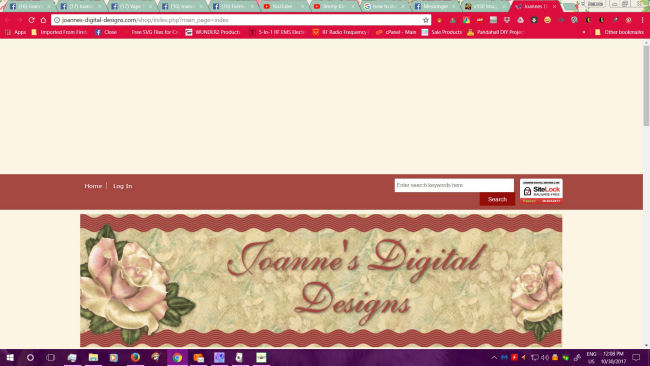

    I finally upgraded my Zen Cart to the latest version! For some reason, I'm getting a huge gap at the top of my store, above the header bar, and I can't figure out why. If I hit refresh in my browser it gets rid of it, but then if I scroll down the page and go back up, the gap is there again. Anyone know why this could be happening? Someone told me that it's an Image Handler issue. I didn't have this happen in my old store. I'm attaching a pic.
    Joanne

    I just visited your site, but am unable to reproduce the error.
    Have cleared your browsers cache?
    Quote Originally Posted by joannem View Post
    Joanne
