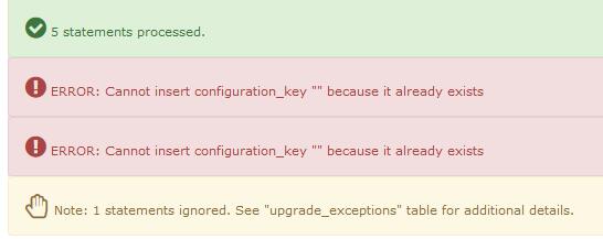

i just installed Zen Colorbox with the "responsive_classic" template, in step 7 Now paste the sql that you copied in step 5 into the sql area and press send, i clicked send, errors displayed at top:
can anyone please advise how to fix this?

If the sql had been run while under a different template, or if it had been installed into a database that had it installed previously and is now upgraded, or if it was installed and never removed (there is a separate sql query to run) then likely to receive sql errors similar to above, though really should have more information available. If there is a sql install error there is likely also going to be an error log in the logs directory.

1. I removed all configuration_key for lightbox, finally i successfully installed colorbox.
