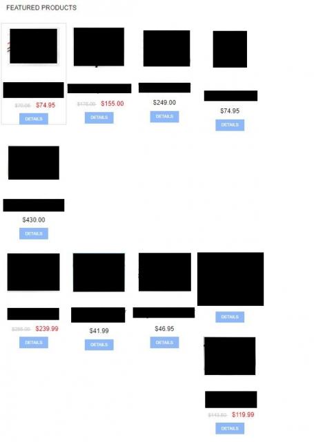

    I have a question for template version 1.4. I installed it on zen cart 1.5.5f. I noticed that, after I turned off "Carousel Featured Products", the featured products displayed on the homepage has placement issue. If I set to display four items per row, some rows show four items correctly, but some rows only show just one item. It may locate on the very left position. Some may locate in the middle.
    By my test, setting to display either 3 per row or 6 per row has no issue. But setting to display either 4 or 5 per row will have this issue.
    I switched back to the default template and this issue is gone.
    Any tips? I really want to display four items per row....

    Quote Originally Posted by njcyx View Post

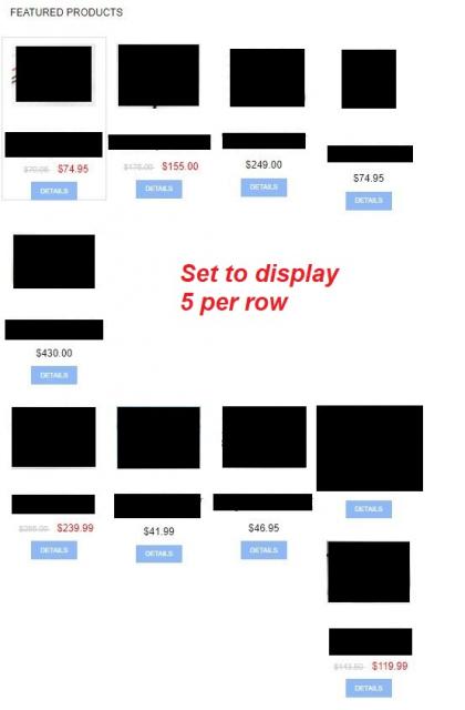

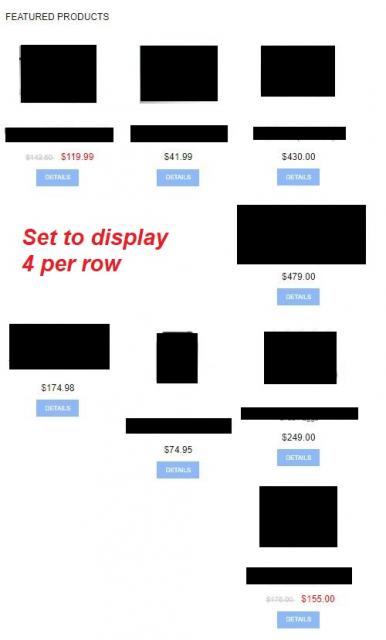

ID:	18618 Click image for larger version.
    If I set to display 5 per row, it will display only 4 per row with this placement issue.
    If I set to display 4 per row, it will display only 3 per row with this placement issue.
    If I set to display either 3 or 6 per row, no issue.
    I would recommend installing the latest version of the template package. Follow the upgrade instructions in the readme
