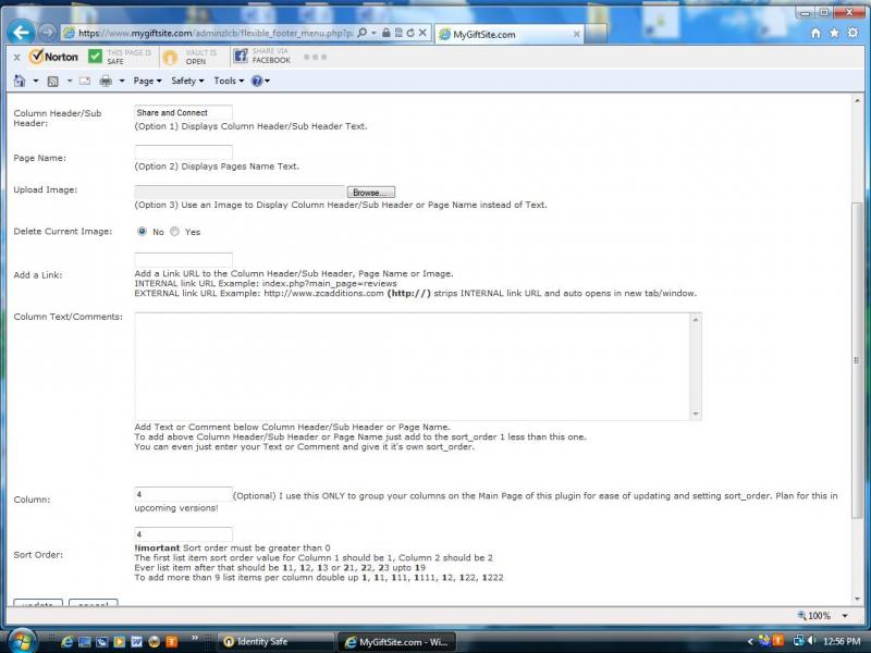

    I am finally getting to creating a facebook page to integrate into my site. When I went to my admin in the flexible footer menu this is what I see:
    Name:  Share and Connect-Flexible Footer.jpg
    Aren't there supposed to be the links in the Column Text/Comments section so they can be edited or am I missing something? Also where can you find the images that are there because I need to delete some of them? For instance, I am not going to need twitter or instagram. I am using v 1.5.4

    Try selecting the "Blank Line" just below the "Share and Connect" listing (per the template ReadMe).
    Been caught there myself a time or two.

    Thank you so much. Kind of throws you off, doesn't it? Now can you tell me how to edit the images?
    Silver
  10. #1000
    Aug 2009
    North Idaho, USA
    2,008
    Default Re: Responsive Sheffield Blue V 2.0!
    Pretty sure the image is the Font-Awesome for the particular media and is embedded within each particular line. If the Twitter line is removed the twitter icon is removed also.... I think.... it's been a while since I've edited that... and I've slept a time or two. :-)
