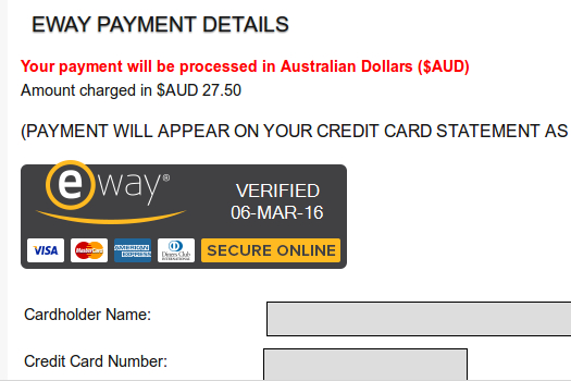

    My preference is to show at checkout the currency in which the charge will be transacted. This gives the customer an indication that a conversion to their own currency will take place, hence they will not be too surprised if the charged amount is not in perfect alignment with the checkout's estimated amount. But if that's not an issue, then DrByte's is a good option.

    Fixed it without hacking core code (as per DrByte's suggestion).
    The shopping cart page(s) still show the chosen currency. Added a few language defines and displayed their relevant content on the checkout_confirmation page. These language defines won't show up if the default currency AUD is selceted - and neither they should show up in this instance as there is nothing to convert.
    See screenie:
