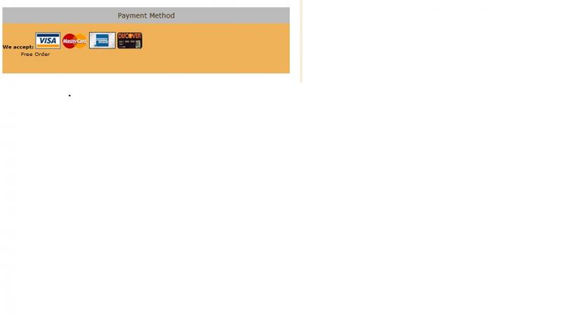

    OPC 2.1.1 installed in zc 156b
    Not losing any sleep here because still playing in the sandbox.
    Guest checkout
    Item purchased: FREE downloadable file
    Step through checkout with email address, phone, etc.
    Payment selection is a bit confusing showing credit cards and a line for free order but no radio button.
    Complete the checkout process.
    Success screen as expected for a normal checkout with a link to the downloadable file(s) which functions as expected.
    The comment about
    You can also download your products at a later time at 'My Account'
    is on the screen. That is really an impossibility, isn't it?
    If the checkout success screen is exited without paying attention to the link, how does a customer get to the download file at a later date?
    I think this might be a 'haven't thought about that moment' or a Rick forgot to take his nap moment.

    If the customer checked out as a guest, they can access their download via the orders_status page. I'll see what's going on with the scenario you posed (i.e. a checkout with a free download) later today.

    When I checked-out a Sample of Document Product Type using Guest Checkout, the text on the checkout_success page reads:
    You can view the status of this order by going to the Order Status page and supplying this order number and your email address.
    Please direct any questions to customer service.
    That text is defined in /includes/languages/english/checkout_success_guest.php (or overridden in YOUR_TEMPLATE) and is displayed by the tpl_checkout_success_guest.php file, present in /template_default but possibly overridden by YOUR_TEMPLATE.

    Thanks Cindy,
    I did find the new checkout success page for guest.
    I've never seen a link to an order status page anywhere other than on the checkout success page which makes it difficult later. Maybe there's a link in the email confirmation. Regardless, I'm sorry to stir the nest with questions that I could have/should have answered myself.

    OPC comes with an 'Orders Status' sidebox which not-logged-in customers can use to lookup their previous orders. The text associated with 'where to find my order's history' is also slightly modified for guest-checkout, pointing them to the orders_status page rather than to their (non-existing) account!
