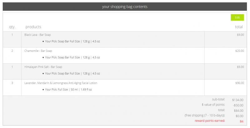

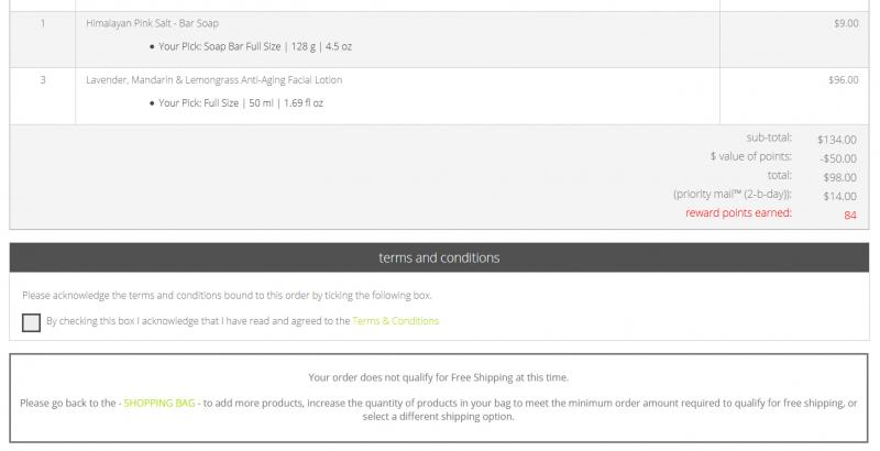

    Since none of your coupons offer free shipping, I think that you can solve your issue by changing the sort-order (Modules->Order Total) of the ot_shipping module so that its processing occurs after the coupon, group discount and rewardpoints modules.
    That way, the order's total will be reduced by those discount modules and the freeoptions method won't kick in since the order's total is now reduced by any of those deductions.
    That method has never worked before I believe it's because freeoptions makes the calculation based on order sub-total and not order total, but I tried it again to see if it would work with OPC with various scenarios.
    1) Placed ot_shipping with a value of 1000 which puts it below ot_total leaving all discounts above, and removed the modification from the tpl_modules_opc_submit_block.php file and it didn't work. freeoptions is still applied even though the cart is way below the minimum for free options. Which is exactly what I can't have.
    2) I placed the modification back on the tpl_modules_opc_submit_block.php file. ot_shipping still below ot_total and it didn't work either. The message that's generated by the code I placed stays on regardless of the shipping method selected unless the shipping method selected increases the order total above the minimum of $100.
    In scenario 2 above the only problem with the little piece of code I wrote is that it isn't taking into consideration that freeoptions must be selected for the message and the hiding of the buttons to kick in. If another shipping option is selected the message should not appear allowing the checkout process to continue, but that isn't happening and I have no idea how to do it.
  5. #1305
