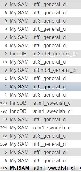

    Hmm, those state-definitions look pretty funky. When you inspect your site's database using your webhost's cPanel->phpMyAdmin, clicking on the site's database name, are all the Collation columns shown as utf8_{something} or are some shown as latin1_{something}?
    Ok I just looked and here is a sample screen shot of just that column.

    Eek! That's not good. What are the DB_CHARSET settings in the site's /includes/configure.php and /YOUR_ADMIN/includes/configure.php?
