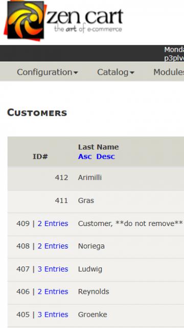

    Just started using OPC 2.3.1 on ZC 1.6.C. Everything to be working as expected so far.
    However, I do have a questions regarding address book. Prior using OPC, I was able to see customer address book. It was useful as sometimes Paypal would change order address to default billing address.
    Please look at screenshot attached. Click image for larger version.
    Is there a way or a setting to see customer address book as before? It used to show as "2 entries" in blue. Theres is nothing being displayed now
    thank you in advance for your help.
  3. #1643
    N of San Antonio TX
    9,718
    13
    What you are seeing is in the admin back end when viewing Customers >> Customers.
    This is not connected to, or effected by OPC.
    If the customer has more than one address, you will see the 2 Entries or 3 Entries. That's where you would click to see the different addresses. If the blue entry is not there, then there is only one registered address for the user.
    That still doesn't mean they can't/won't add a new address to PayPal. Still, nothing to do with OPC.

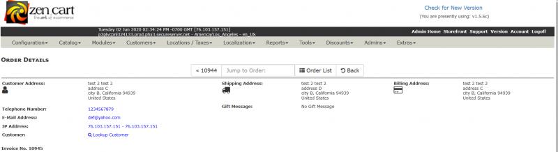

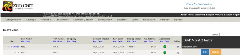

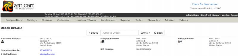

  5. #1645
    Apr 2011
    586
    here are some screenshot to try to explain it better.
    Using OPC does not seems to register address into customer address book.
    I run some test as follow
    test 1 with OPC to true.
    payment is check/money order
    The order displays both address correctly but no entries in address book.
    test 2 with OPC to false.
    The order displays both address correctly and there is 2 entries in address book as seen in first screen shot above.
    Is there a setting in OPC configuration that I missed?
    Thank you for your time and help. It is much appreciated.
