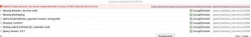

    Are there additional jQuery/javascript issues? Use your browser's 'developer tools' to view the console-log.
  5. #2085
    Jan 2007
    Illinois, USA
    329
    These are the rseults when its activated:
    [Error] Failed to load resource: the server responded with a status of 500 (Internal Server Error) (success.png, line 0)
    [Log] Missing #ottotal > div:first-child (jquery.checkout_one.min.js, line 5)
    [Log] Missing #otshipping (jquery.checkout_one.min.js, line 5)
    [Log] setFormSubmitButton, payment-module: moneyorder (jquery.checkout_one.min.js, line 5)
    [Log] Showing "confirm" (jquery.checkout_one.min.js, line 5)
    [Log] Setting orderConfirmed (0), submitter (null) (jquery.checkout_one.min.js, line 5)
    [Log] jQuery version: 3.5.1 (jquery.checkout_one.min.js, line 5)
    Attachment 19802

    Quote Originally Posted by Carbonless View Post
    Attachment 19802
    There's some kind of PHP-related error during the checkout; check your site's /logs sub-directory for additional information.
