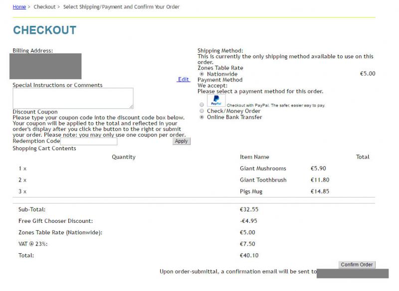

    Hi @lat9 thanks for the mod and was really looking forward to having on my site but it's not working for me, well it doesn't look as it should according to what the customer should see, basically its seems that the ajax part doesn't work and the formatting is plain text see attached picClick image for larger version.
    prob some other jscript file causing this but not sure, ? maybe you can shed some light, cheers
  4. #324
    13,971
    96
    @jagall, I just went to your site and see that you're currently using the Tableau template. Unfortunately, that template has been previously reported (as mentioned in the readme) as incompatible with OPC.
  5. #325
    Mar 2011
    Ireland
    286
    @lat9 thanks for getting back to me so quickly, just my luck! I didn't see a ref to troubleshooting in the readme but obviously missed that one maybe i need to change templates!!! thank you
  6. #326
    13,971
    96
    @jagall, the first page of the readme identifies known incompatibilities as well as a list of order-total, shipping and payment modules that the Zen Cart community have found to be compatible.

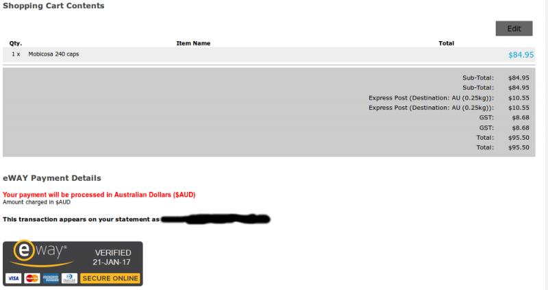

    ZC 1.5.5d - local development, not publicly accessible
    OPC 1.0.12beta
    no template overrides
    Payment module eWay - requires the confirmation page /index.php?main_page=checkout_one_confirmation
    All order totals are duplicated when using OPC. This does not happen when I am using the standard 3 page checkout.
    Checked relevant OPC includes/modules/pages/(etc) and OPC template files - to no avail.
    What may be wrong??
    Thanks / Frank
  8. #328
    13,971
    96
    Frank, does the order-total duplication occur on both the checkout_one and the checkout_one_confirmation pages? I will admit that this issue has me a bit puzzled.
  9. #329
    13,971
    96
    Never mind; it's on the confirmation page.
    I've got the payment method re-enabled on my demo site and I see the issue; an issue seen is an issue for which a solution can be found!
  10. #330
    13,971
    96
    I've created an issue on GitHub to track this change for the upcoming v1.0.12 release. The solution to the order-totals duplication is available on GitHub at this time.
    Please note that a change to the checkout_one_confirmation page's template is required, so watch for that on a update if you've created a template-override for your store.
