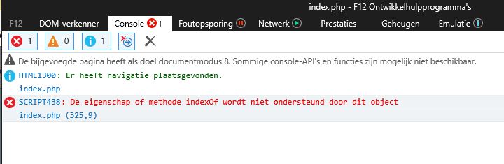

    Hi Lat9, thanks for your help so far! I have installed again the original tpl_chechout_one_default and figth my way through WS3 validator. Most of the errors comes from the main page, but I was able to tackle them all! The page is error free for now, but still no confirmation page and still have the error message "Your order's details have changed. Please review the current values and re-submit.".
    In IE10 F12 console I see a error. See the attached image.
    Do you have any clue how to fix this?
  8. #658
    13,909
    96
    @jolion, please follow these instructions to create a OPC log; I'll send you my direct email via PM and you can email the log to me once you've created it.
    1. Make sure that your admin's Configuration->One Page Checkout->Debug is set to true.
    2. Log into your site, place an item in your cart and click the "Checkout" button.
    3. Using your webhost's cPanel's File Explorer or via FTP, delete any existing /logs/myDEBUG-one-page-checkout*.log files.
    4. Click the "Confirm Order" button.
    5. Navigate to your site's /logs directory, copy that most recent one-page-checkout log and email it to me.
