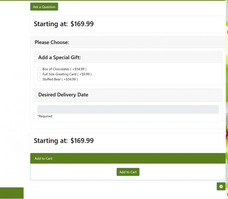

    Apart from my stylesheet issue, i have another problems.
    The "starting at " is shown twice on my product page. ( see screenshot)
    I am not sure if it is template related or not but i would like to remove the bottom one ( "starting at " above the add to cart button)
    I tried to search the thread for product_info or starting but came up empty
    Thank you for your help on this
  4. #654
    Mar 2011
    103
    ^ I wanted to do the same for my site but unfortunately on non-attribute products the bottom card is default so can't be removed.
    To remove the top "starting at" I added the following to stylesheet.css
    #productsPriceTop-card {
    display:none;

  6. #656
    Apr 2011
    586
    Quote Originally Posted by gsh68 View Post
    display:none;
    Thanks for the suggestion
